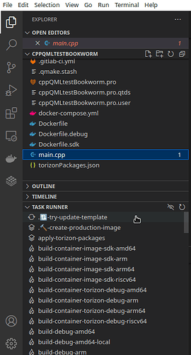

As a quick note, to update the templates, you can also manually run a task called try-update-template by clicking on it in the task runner of an open project, like shown in the image below:

you got me wrong, it was not about updating my project. the issue was that the try-update-template task never got the real up to date template. so i did not get newest changes of templates since the templates that come with the extension were not updated themself.
