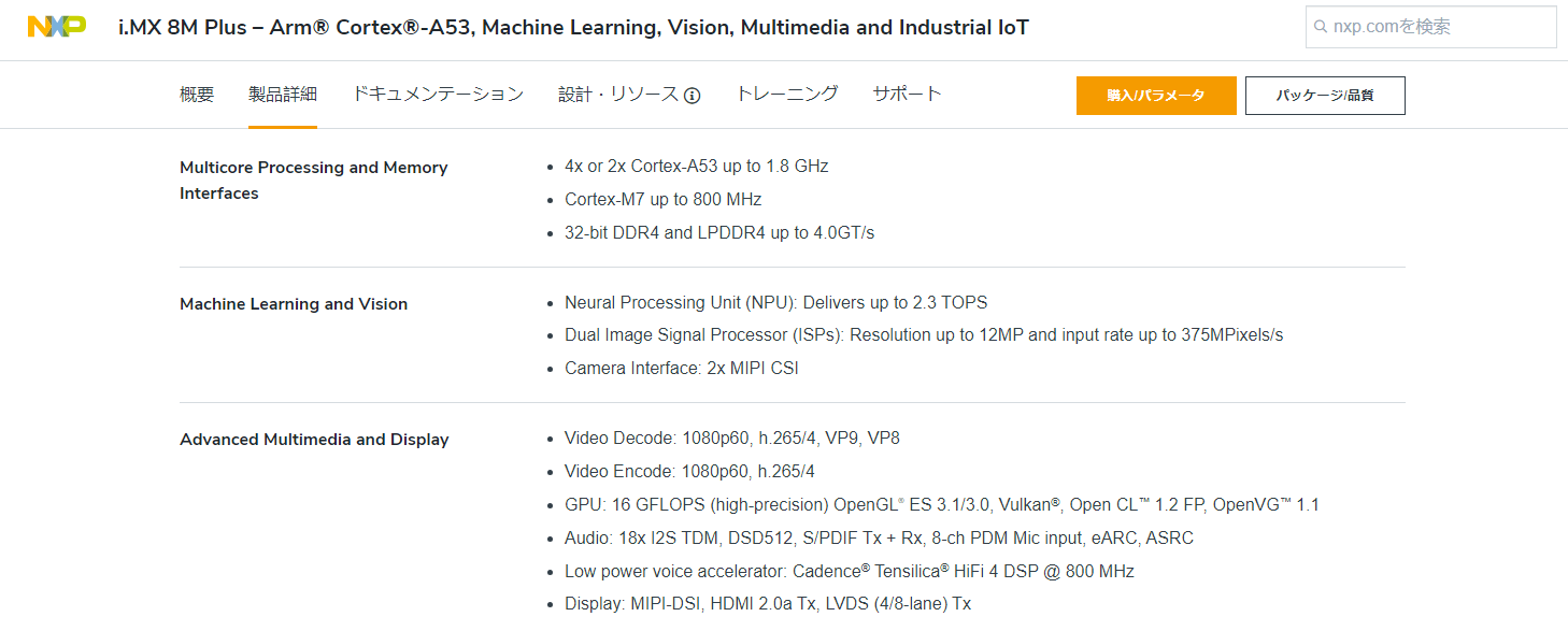

Does Verdin imx8m plus quad 2GB WB IT support HD VPU H265 encode operation?
If I understood correctly, Alvero.tx has stated that VPU support is added in below thread
Does the latest BSP support HD VPU H265 encode operation out of the box?
