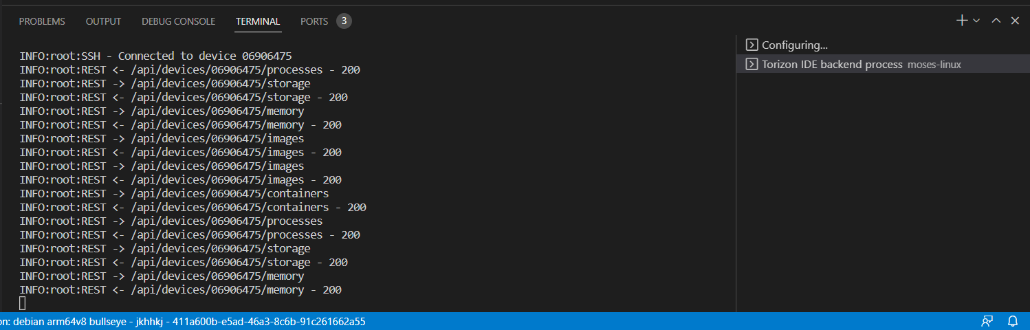

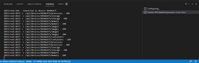

Hi @changdixia ,
Can you reproduce your issue and send the resulting extension backend logs found here:
Send the output in a text file and I’ll pass it to the extension team for further analysis.
Lucas Akira
Torizon_backend.txt (50.9 KB)
I attached torizon backend process fille above
Thanks
Chang Di (Jack) Xia
This problem is fixed by "Google seach "
I just run command in WSL command line below:
sudo chmod 777 /var/run/docker.sock
