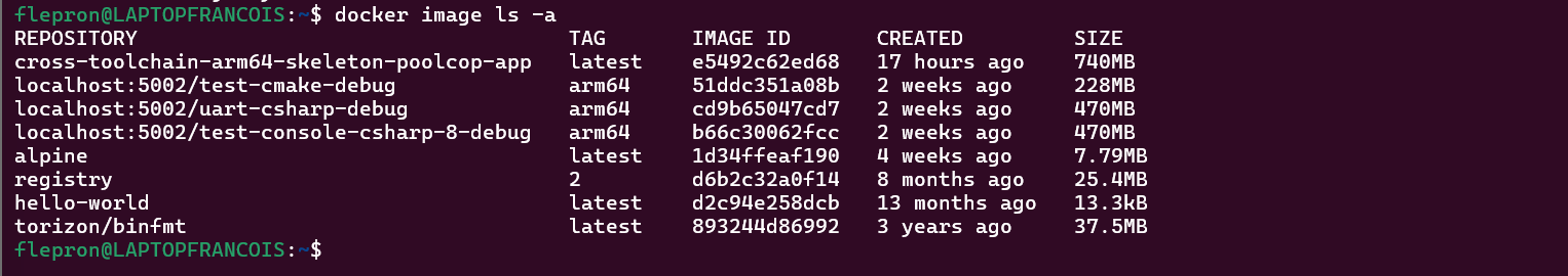

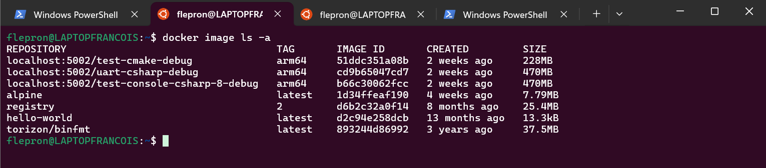

When I list my images on my WSL2 Ubuntu 22.04.4 LTS, I have the following list:
So, my image is not in the list which is normal since I have just removed it. (docker rmi .
Now, I clean my arm64 build and after I build the container release arm64 by doing so:
After, I list once again my docker images on my WSL2 Ubuntu 22.04:
I see in the list that there is an new image which appears, which has been created 17 hours ago.
The name of my application is skeleton-poolcop-app.
There is cross-toolchain-arm64-skeleton-poolcop-app in the list, but honestly I would like to know what this image is corresponding to, because in my mind of application programmer, clean-arm64 or the clean process, more generally, means usually the deletion of the files generated during the build process, like the object files (compilation of *.c and *.cpp into .o) and the result of the linkage (skeleton-poolcop-app).
There’s definitely something I’m confusing terminology with. But, let’s continue.

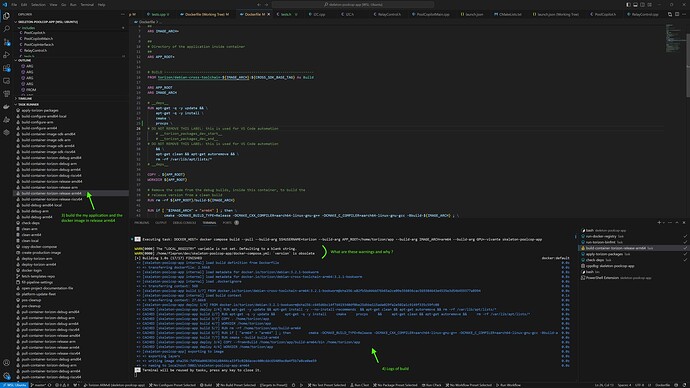

After, as I do not want to debug my application, but build it in release mode to make it the smallest one, as well as the image, I click on the task named “build-container-torizon-release-arm64”.
 *  Executing task: DOCKER_HOST= docker compose build --pull --build-arg SSHUSERNAME=torizon --build-arg APP_ROOT=/home/torizon/app --build-arg IMAGE_ARCH=arm64 --build-arg GPU=-vivante skeleton-poolcop-app
WARN[0000] The "LOCAL_REGISTRY" variable is not set. Defaulting to a blank string.
WARN[0000] /home/flepron/dev/skeleton-poolcop-app/docker-compose.yml: `version` is obsolete
[+] Building 1.0s (17/17) FINISHED                                                                                                                                                                            docker:default
 => [skeleton-poolcop-app internal] load build definition from Dockerfile                                                                                                                                               0.0s
 => => transferring dockerfile: 2.56kB                                                                                                                                                                                  0.0s
 => [skeleton-poolcop-app internal] load metadata for docker.io/torizon/debian:3.2.1-bookworm                                                                                                                           0.8s
 => [skeleton-poolcop-app internal] load metadata for docker.io/torizon/debian-cross-toolchain-arm64:3.2.1-bookworm                                                                                                     0.8s
 => [skeleton-poolcop-app internal] load .dockerignore                                                                                                                                                                  0.0s
 => => transferring context: 56B                                                                                                                                                                                        0.0s
 => [skeleton-poolcop-app build 1/7] FROM docker.io/torizon/debian-cross-toolchain-arm64:3.2.1-bookworm@sha256:e82fb5bd44dd76b65a2ce09e356036cac569384643e4535e3d546459377a8994                                         0.0s
 => [skeleton-poolcop-app internal] load build context                                                                                                                                                                  0.1s
 => => transferring context: 27.66kB                                                                                                                                                                                    0.0s
 => [skeleton-poolcop-app deploy 1/4] FROM docker.io/torizon/debian:3.2.1-bookworm@sha256:c645d6bc14f7d419340df0be25dbbe115ada029fa2e502a1c9149f335c59fc08                                                              0.0s
 => CACHED [skeleton-poolcop-app deploy 2/4] RUN apt-get -y update && apt-get install -y --no-install-recommends  && apt-get clean && apt-get autoremove && rm -rf /var/lib/apt/lists/*                                 0.0s
 => CACHED [skeleton-poolcop-app build 2/7] RUN apt-get -q -y update &&     apt-get -q -y install     cmake     procps     &&     apt-get clean && apt-get autoremove &&     rm -rf /var/lib/apt/lists/*                0.0s
 => CACHED [skeleton-poolcop-app build 3/7] COPY . /home/torizon/app                                                                                                                                                    0.0s
 => CACHED [skeleton-poolcop-app build 4/7] WORKDIR /home/torizon/app                                                                                                                                                   0.0s
 => CACHED [skeleton-poolcop-app build 5/7] RUN rm -rf /home/torizon/app/build-arm64                                                                                                                                    0.0s
 => CACHED [skeleton-poolcop-app build 6/7] RUN if [ "arm64" = "arm64" ] ; then         cmake -DCMAKE_BUILD_TYPE=Release -DCMAKE_CXX_COMPILER=aarch64-linux-gnu-g++ -DCMAKE_C_COMPILER=aarch64-linux-gnu-gcc -Bbuild-a  0.0s
 => CACHED [skeleton-poolcop-app build 7/7] RUN cmake --build build-arm64                                                                                                                                               0.0s
 => CACHED [skeleton-poolcop-app deploy 3/4] COPY --from=Build /home/torizon/app/build-arm64/bin /home/torizon/app                                                                                                      0.0s
 => CACHED [skeleton-poolcop-app deploy 4/4] WORKDIR /home/torizon/app                                                                                                                                                  0.0s
 => [skeleton-poolcop-app] exporting to image                                                                                                                                                                           0.0s
 => => exporting layers                                                                                                                                                                                                 0.0s
 => => writing image sha256:7df66a04638341d8444ca33f3c028dacec400cddc65409ac0a4f5b7a8ce0ae59                                                                                                                            0.0s
 => => naming to localhost:5002/skeleton-poolcop-app:arm64                                                                                                                                                              0.0s
Now, I list my images on my WSL2 Ubuntu 22.04:
flepron@LAPTOPFRANCOIS:~$ docker image ls -a
REPOSITORY                                   TAG       IMAGE ID       CREATED         SIZE
cross-toolchain-arm64-skeleton-poolcop-app   latest    e5492c62ed68   19 hours ago    740MB
localhost:5002/skeleton-poolcop-app          arm64     7df66a046383   20 hours ago    115MB
localhost:5002/test-cmake-debug              arm64     51ddc351a08b   2 weeks ago     228MB
localhost:5002/uart-csharp-debug             arm64     cd9b65047cd7   2 weeks ago     470MB
localhost:5002/test-console-csharp-8-debug   arm64     b66c30062fcc   2 weeks ago     470MB
alpine                                       latest    1d34ffeaf190   4 weeks ago     7.79MB
registry                                     2         d6b2c32a0f14   8 months ago    25.4MB
hello-world                                  latest    d2c94e258dcb   13 months ago   13.3kB
torizon/binfmt                               latest    893244d86992   3 years ago     37.5MB
So, I see another image which has been created 20 hours ago with the name of the of my application. I do not understand why this image has not the timestamp of now, because I’ve just built the image.

  • build-container-torizon-release-arm64
  • pull-container-torizon-release-arm64
  • push-container-torizon-release-arm64
  • deploy-torizon-arm64
I do not know which one creates the docker image release arm64 and which one pushes this image on the target device (Toradex Verdin i.MX 8M Plus).

All the tasks here for the project you can see their definition and what they do in the tasks.json file of your VSCode project. As a brief summary;
    • This builds and produces the release version of your application container image.
    • This pulls the release version of your applcation container image onto your target device so the container image is available on that device.
    • This pushes your application container image to the container registry that you have configured in your project.
    • This is a composite task that executes several other tasks in sequence. Basically it builds pushes, pulls, and finally runs the debug version of your application container.
Given the above, build-container-torizon-release-arm64 creates your release image. While pull-container-torizon-release-arm64 pulls it onto your target device. Though keep in mind for it to be pulled onto your device it needs to first be pushed to a container registry somewhere via push-container-torizon-release-arm64. It’s like pushing your code to a git repository. It needs to be pushed somewhere, before it can be pulled somewhere else.
