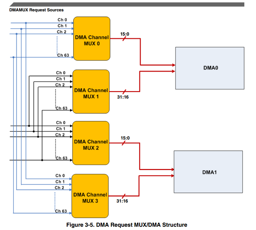

Channels 0 to 10 and 17 to 20 of DMA1 are in use. If you plan to implement DMA on M4 I would advise you to use DMA2 so you wont have any conflicts.
do you mean DMA0 and DMA1 respectively? (see attached image from VFxxx Controller Reference Manual)
Yes DMA1 on your pic
