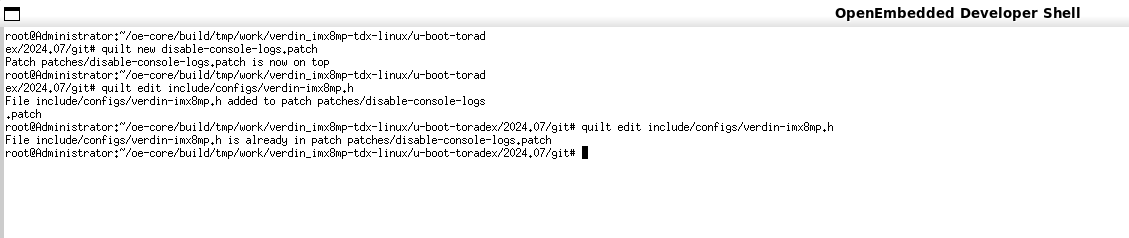

hari@Administrator:~/oe-core/layers/meta-lokbest/recipes-bsp$ cat u-boot/files/verdin-imx8mp/disable-console-logs.patch
diff --git a/include/configs/verdin-imx8mp.h b/include/configs/verdin-imx8mp.h
index 1234567..abcdefg 100644
--- a/include/configs/verdin-imx8mp.h
+++ b/include/configs/verdin-imx8mp.h
@@ -XX,X +XX,X @@

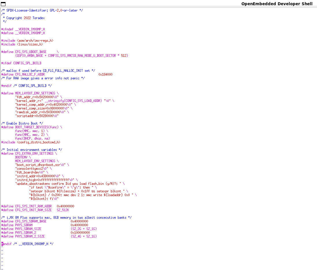

- "tdxargs=\0" \
+ "tdxargs=quiet loglevel=0 logo.nologo vt.global_cursor_default=0 vt.default_redraw=0\0" \
hari@Administrator:~/oe-core/layers/meta-lokbest/recipes-bsp$ cat u-boot/files/verdin-imx8mp/fast-boot-config.patch
@@ -XX,X +XX,X @@
-#define CONFIG_BOOTDELAY 1
+#define CONFIG_BOOTDELAY 0
hari@Administrator:~/oe-core/layers/meta-lokbest/recipes-bsp$ cat u-boot/u-boot-toradex_%.bbappend

ERROR: u-boot-toradex-1_2024.07-r0 do_patch: Applying patch 'disable-console-logs.patch' on target directory '/home/hari/oe-core/build/tmp/work/verdin_imx8mp-tdx-linux/u-boot-toradex/2024.07/git'
CmdError('quilt --quiltrc /home/hari/oe-core/build/tmp/work/verdin_imx8mp-tdx-linux/u-boot-toradex/2024.07/recipe-sysroot-native/etc/quiltrc push', 0, 'stdout: Applying patch disable-console-logs.patch
patching file include/configs/verdin-imx8mp.h
patch: **** missing line number at line 5: @@ -XX,X +XX,X @@
Patch disable-console-logs.patch does not apply (enforce with -f)
stderr: ')
