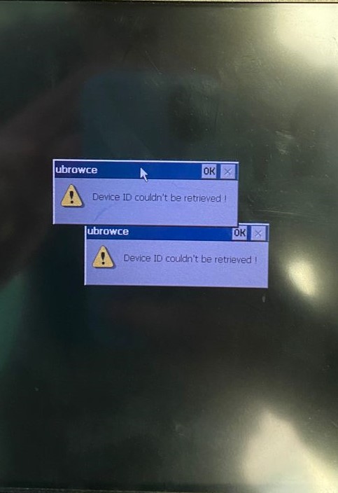

Hi, I have a problem with my Colibri iMX6 after the system boot up this error appear on-screen-i cannot access the IP address of this kit, one of our employee suddenly change the ip address of this machine. The space key not working for accessing to the boot menu.
Could you please enable Debug Messages over Serial ,
collect log and share it?
Could you please provide more details?
Bootloader menu space not working connect over PS2 and USB from device manufacturer board and colibri carrier board.
Also i have this problem from my com terminal
Space bar must be pressed at terminal programm. Keyboard connected to a carrier board doesn’t affect bootloader.
