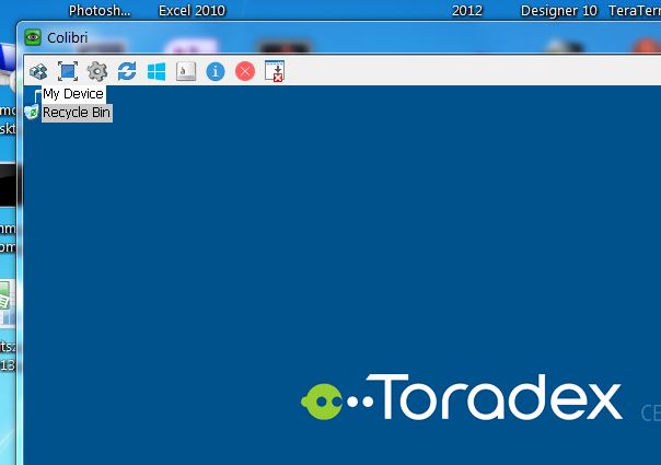

I successfully installed WEC2013 on a new Colibri iMX7D, works, but suddenly the Icons on the Desktop getting missaranged. I tried to move the Icons, ser ‘AutoArrange’ but nothing helps.
Any hint to fix that?

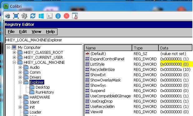

fixed now.
There is a registry key determining the arrangement of the icons. For what reason ever, something changed this setting (I am sure I dont’t do that !!!)
Seting this property to 0, everything works as before.
With best regards
Gerhard
Dear @Gerhard
In WEC2013 the icon display on the desktop is directly linked to the display style in the regular file explorer (My Device).
I assume you were browsing some folders and switched to list view, then saved the registry.
Regards, Andy
