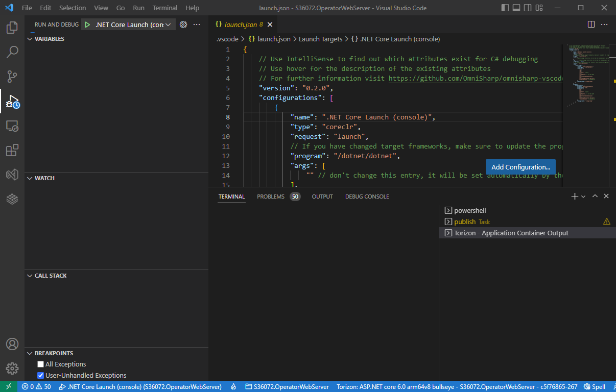

I am trying to resolve a Docker networking issue. One of my applications is a .NET/Blazor web server that I’m developing with Visual Studio Code. I can debug it just fine with the default configuration, but if I change the network mode by adding the “extraparms” parameter “network_mode host”, the debug session gets stuck – i.e. it seems to hang up after I see the “Running application: starting new instance” status message at the bottom right, and the app does not appear to start. I also observe the following:
  • The TERMINAL window clears, but the view does not swap to the DEBUG CONSOLE window (which is what I normally see)
  • The Debug toolbar does not appear.
  • At the top left in the Run and Debug panel, the icon shows a permanent blue clock, and there is a continuously scrolling blue indicator at the top. Here’s a screen shot of this:
  • I cannot do anything more until I stop the debugger using Shift-F5.

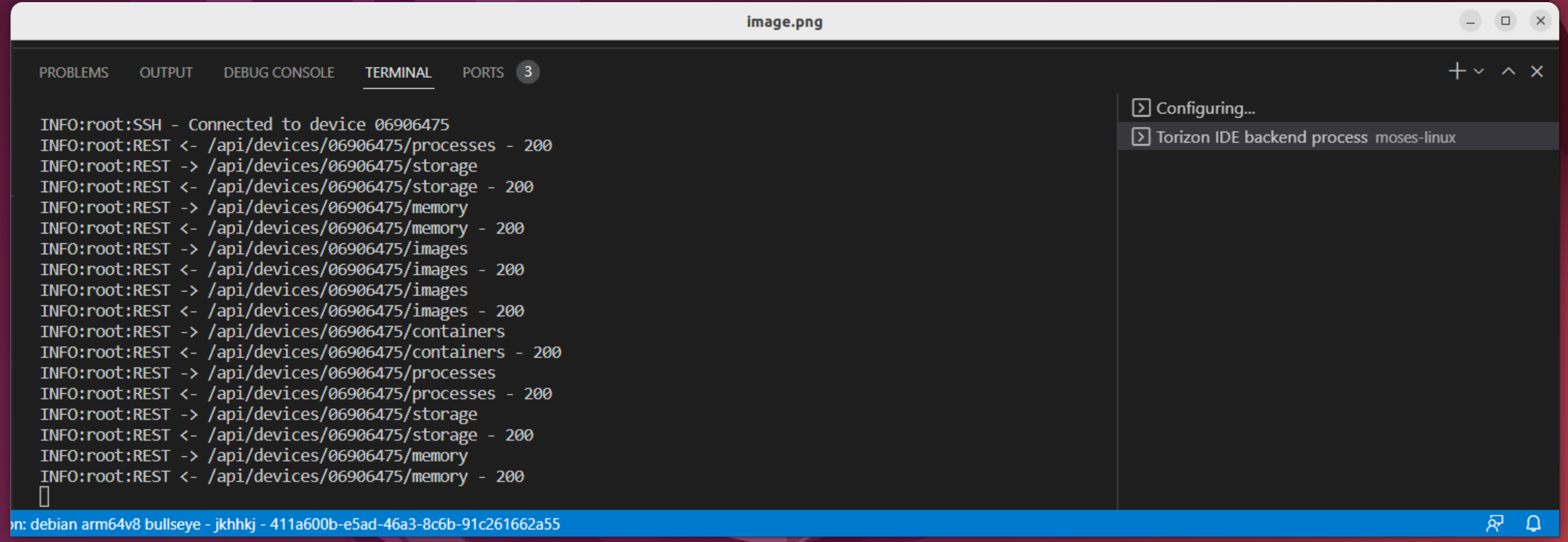

Today, I can see the IDE backend process terminal - here it is at the point of the hang-up:
Backend IDE Log.txt (8.8 KB)

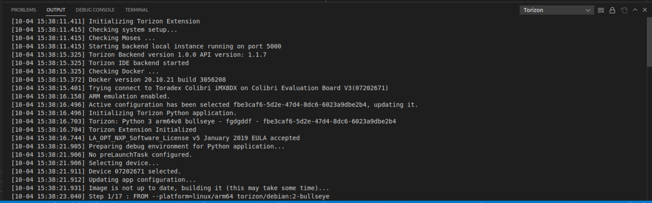

And here is the Output log at the same time:
Output Log 2.txt (5.1 KB)
