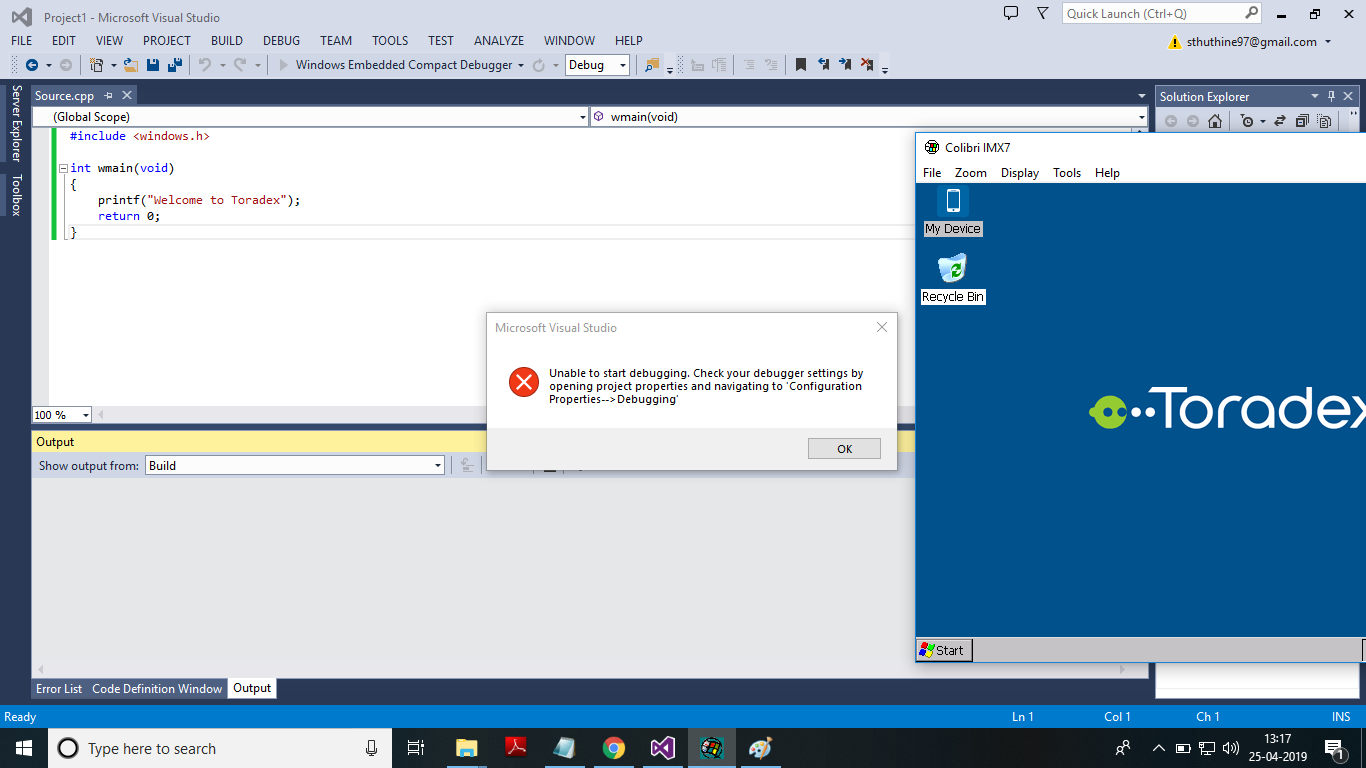

I did everything almost correctly.I Ran the debugger client on the target board. Captured the IP address from the message displayed. Configured the IP address in the Visual Studio project (project->Properties. Under Configuration Properties, select Debugging. Inserted the target IP Address. Now why this error is occuring ? Please suggest me a solution . I have attached the following occured error message.
Dear @sth
Keep the Debugger Client application running on the target. Otherwise the debugger will only connect for a short time window.
If this does not help, please try the following:
- ping the IP address from your PC - do you get a proper response from the Colibri?
- Enable the debug messages and send us the complete debug log from booting the device until the debug connection fails. Is there any hint about the failure reason?
Regards, Andy
