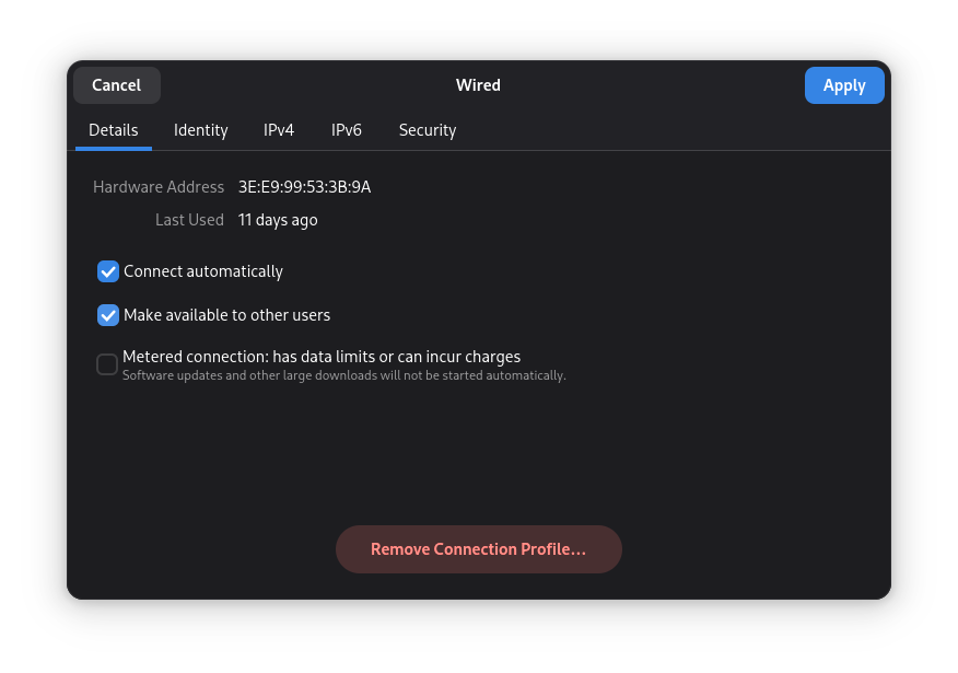

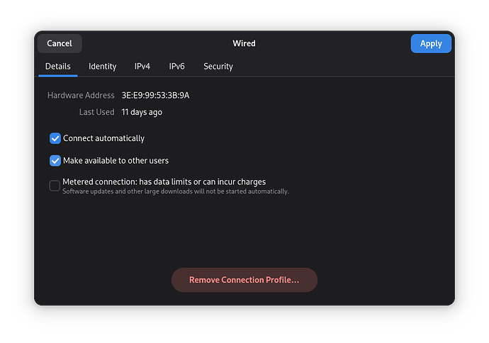

There are already 2 solutions, I still add one as this page is the first hit when looking for this.
On Debian if using the default Gnome desktop, you can also just go to the network settings, edit the USB network interface and activate the Connect automatically option.
On a fresh Trixie (Debian 13) install it was not activated by default. Seems on older installs in was by default on.
