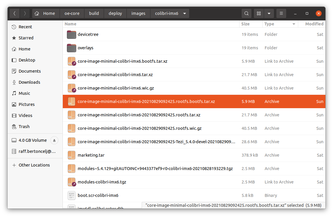

First problem:
The bitbake generate Symbolic links to TAR files.
These symbolic links are not handled correctly by Easy installer.
Report, that it does not know these “tar” files.
I manually delete links and rename tar files as defined in json file:“image-core-image-minimal.json”
After renaming the files, the “Easy installer” correctly recognized the files and also uploaded them and on the end reported that I can reboot the module.

Bitbake successfully created files in /deploy/images/coliri-imx6.
The problem is that same created files are not recognizable by Easy Installer.
These files are “link files”. Look attched picture with
