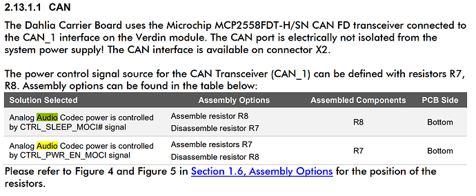

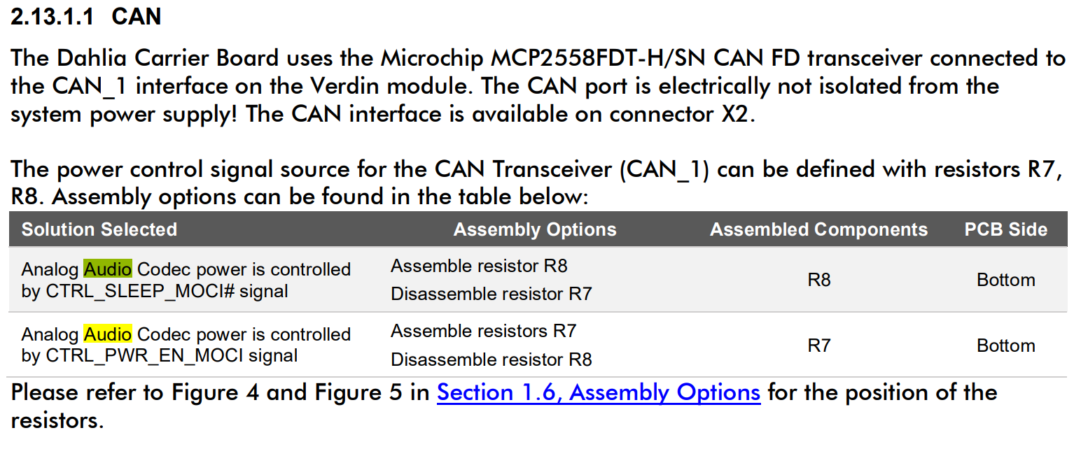

Being software and not hardware, there are two things that bug me in the Dahlia data sheet.
That makes it sound like “if the Carrier is configured for CAN, Audio no have power.”
Again, I’m not a hardware guy. I don’t know how to check if CAN is even configured on this board. It was sent to me the way it was sent to me.

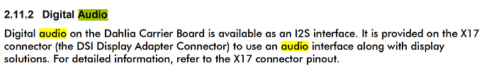

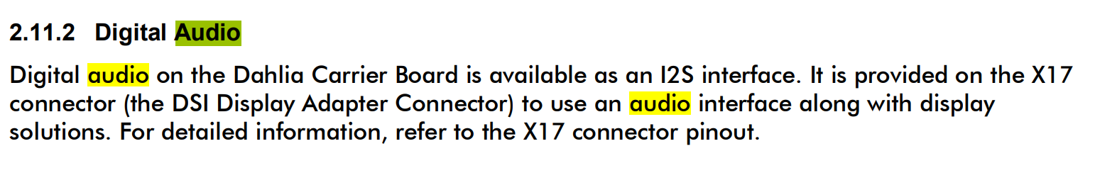

The other potential Red Herring is as follows:
To a software guy that sounds like a super secret configuration bit must be flipped somewhere.

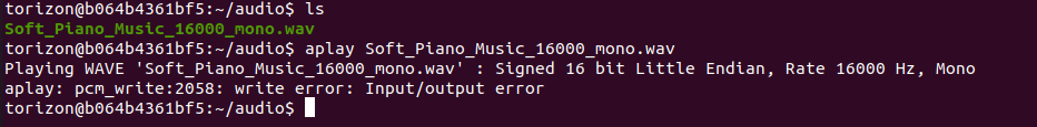

Even aplay produces no sound
It hangs trying to write for quite a while then errors out.
