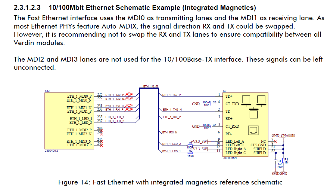

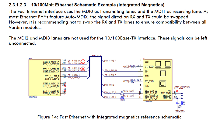

We are working with Verdin imx8mm, dev board.
In our last custom PCB, we discovered that the ACT/LINK LED of the Ethernet Interface keep green when we unplug the ethernet cable; the PCB reference of the design it comes from:
Everything works fine for now,
Do you have any idea what could be wrong?
