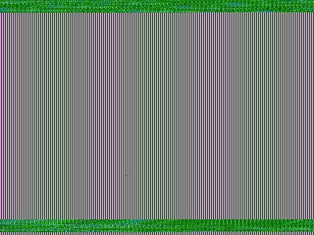

and /dev/video0 device has appeared, but when I`m trying to display image from camera I can’t see any proper image and facing errors as below:

When Im running gstreamer without any params as gst-launch -e v4l2src device=“/dev/video0” ! xvimagesink` I can see a broken 521-capture1.jpeg
How can I add nvvidconv and nvxvimagesink to gstreamer, or is it any other way to make it working?

So, I have downloaded latest BSP 2.7 for Tegra T30 from Toradex website and still, the image seems to be corrupted as on the picture above. Any idea how to track, if is it a hardware or software issue?

I proceeded exactly as that article. I cannot see any errors. Just no correct image. Image as shown in the attachment above. Additionally, after a while of using camera system hangs completely using BSP 2.7 and needs a cold restart.
We’ve seen this type of behaviour when there were serious signal integrity issues/not connected pairs on CSI bus. Please double check the hw design/connections.
