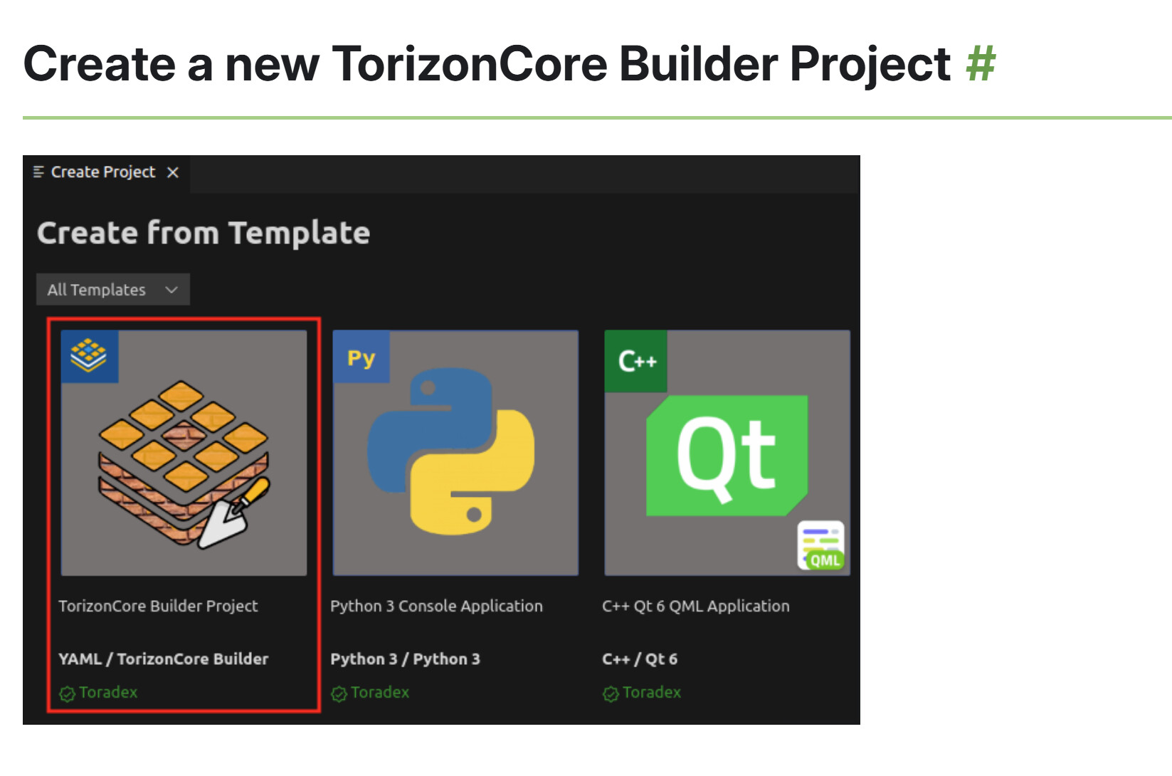

I am working through the instructions of how to set up TorizonCore builder in VSCode.
Step 1 is simply this:
How do I get to this screen?

Hello! To access the screen shown in your screenshot within Visual Studio Code, please follow these steps:
Note:
Refresh Devices icon in the panel.Setup prerequisites:
credentials.zip file and obtained your Torizon Cloud API Client ID and Client Secrets.For detailed step-by-step instructions, please refer to the official guide:
Is the TorizonCore Builder auxiliary extension also installed?: TorizonCore Builder - Visual Studio Marketplace
It should have been installed alongside the main extension as well. From there you can just create a new project as shown here: Create a Single-Container Project | Toradex Developer Center
The solution is that you need to be in a fresh VSCode window (without a folder open) then click the “explorer” tab and then click “Create Torizon Project”. That is how you get to step 1 of the tutorial.
