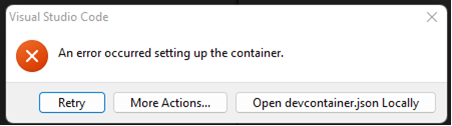

Today my computer “went dark” like a bluescreen, except… no blue screen)
But when it came back up, my development environment shows an error…
I have never seen this error before,
A restart of VSCODE or reboot did not help:

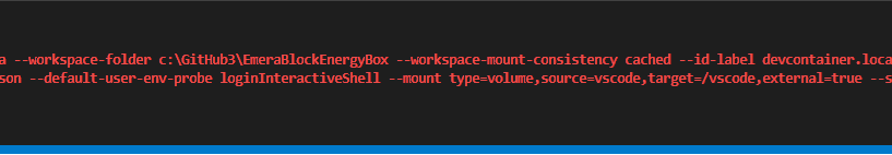

remoteContainers-2022-07-06T13-51-29.159Z.log
[2022-07-06T13:51:29.232Z] Start: Resolving Remote
[2022-07-06T13:51:29.232Z] Remote-Containers 0.238.3 in VS Code 1.68.1 (30d9c6cd9483b2cc586687151bcbcd635f373630).
[2022-07-06T13:51:29.254Z] Setting up container for folder or workspace: c:\GitHub3\EmeraBlockEnergyBox
[2022-07-06T13:51:29.259Z] Start: Check Docker is running
[2022-07-06T13:51:29.259Z] Start: Run: docker version --format {{.Server.APIVersion}}
[2022-07-06T13:51:29.557Z] Stop (298 ms): Run: docker version --format {{.Server.APIVersion}}
[2022-07-06T13:51:29.558Z] Server API version: 1.41
[2022-07-06T13:51:29.558Z] Stop (299 ms): Check Docker is running
[2022-07-06T13:51:29.559Z] Start: Run: docker volume ls -q
[2022-07-06T13:51:29.954Z] Stop (395 ms): Run: docker volume ls -q
[2022-07-06T13:51:30.057Z] Start: Run: docker ps -q -a --filter label=vsch.local.folder=c:\GitHub3\EmeraBlockEnergyBox --filter label=vsch.quality=stable
[2022-07-06T13:51:30.544Z] Stop (487 ms): Run: docker ps -q -a --filter label=vsch.local.folder=c:\GitHub3\EmeraBlockEnergyBox --filter label=vsch.quality=stable
[2022-07-06T13:51:30.545Z] Start: Run: docker ps -q -a --filter label=devcontainer.local_folder=c:\GitHub3\EmeraBlockEnergyBox
[2022-07-06T13:51:31.127Z] Stop (582 ms): Run: docker ps -q -a --filter label=devcontainer.local_folder=c:\GitHub3\EmeraBlockEnergyBox
[2022-07-06T13:51:31.128Z] Start: Run: docker inspect --type container 1b68aef54266
[2022-07-06T13:51:31.785Z] Stop (657 ms): Run: docker inspect --type container 1b68aef54266
[2022-07-06T13:51:31.788Z] Start: Run: C:\Users\LeighBoyd\AppData\Local\Programs\Microsoft VS Code\Code.exe c:\Users\LeighBoyd.vscode\extensions\ms-vscode-remote.remote-containers-0.238.3\dist\spec-node\devContainersSpecCLI.js up --user-data-folder c:\Users\LeighBoyd\AppData\Roaming\Code\User\globalStorage\ms-vscode-remote.remote-containers\data --workspace-folder c:\GitHub3\EmeraBlockEnergyBox --workspace-mount-consistency cached --id-label devcontainer.local_folder=c:\GitHub3\EmeraBlockEnergyBox --log-level debug --log-format json --config c:\GitHub3\EmeraBlockEnergyBox.devcontainer\devcontainer.json --default-user-env-probe loginInteractiveShell --mount type=volume,source=vscode,target=/vscode,external=true --skip-post-create --update-remote-user-uid-default on --mount-workspace-git-root true
[2022-07-06T13:51:32.192Z] remote-containers 0.238.3.
[2022-07-06T13:51:32.192Z] Start: Run: docker buildx version
[2022-07-06T13:51:32.797Z] Stop (605 ms): Run: docker buildx version
[2022-07-06T13:51:32.798Z] Start: Resolving Remote
[2022-07-06T13:51:32.803Z] Start: Run: git rev-parse --show-cdup
[2022-07-06T13:51:32.870Z] Stop (67 ms): Run: git rev-parse --show-cdup
[2022-07-06T13:51:32.873Z] Start: Run: docker ps -q -a --filter label=devcontainer.local_folder=c:\GitHub3\EmeraBlockEnergyBox
[2022-07-06T13:51:33.355Z] Stop (482 ms): Run: docker ps -q -a --filter label=devcontainer.local_folder=c:\GitHub3\EmeraBlockEnergyBox
[2022-07-06T13:51:33.356Z] Start: Run: docker inspect --type container 1b68aef54266
[2022-07-06T13:51:33.812Z] Stop (456 ms): Run: docker inspect --type container 1b68aef54266
[2022-07-06T13:51:33.813Z] Start: Starting container
[2022-07-06T13:51:33.814Z] Start: Run: docker start 1b68aef54266190cdad46ae9feec578ae7a1e7c3f45a1aae079ec24f6c96d215
[2022-07-06T13:51:34.457Z] Stop (643 ms): Run: docker start 1b68aef54266190cdad46ae9feec578ae7a1e7c3f45a1aae079ec24f6c96d215
[2022-07-06T13:51:34.449Z] Error: Command failed: docker start 1b68aef54266190cdad46ae9feec578ae7a1e7c3f45a1aae079ec24f6c96d215
[2022-07-06T13:51:34.449Z] at NR (c:\Users\LeighBoyd.vscode\extensions\ms-vscode-remote.remote-containers-0.238.3\dist\spec-node\devContainersSpecCLI.js:239:1572)
[2022-07-06T13:51:34.449Z] at Jy (c:\Users\LeighBoyd.vscode\extensions\ms-vscode-remote.remote-containers-0.238.3\dist\spec-node\devContainersSpecCLI.js:239:1510)
[2022-07-06T13:51:34.449Z] at processTicksAndRejections (node:internal/process/task_queues:96:5)
[2022-07-06T13:51:34.450Z] at async zR (c:\Users\LeighBoyd.vscode\extensions\ms-vscode-remote.remote-containers-0.238.3\dist\spec-node\devContainersSpecCLI.js:245:2006)
[2022-07-06T13:51:34.450Z] at async nb (c:\Users\LeighBoyd.vscode\extensions\ms-vscode-remote.remote-containers-0.238.3\dist\spec-node\devContainersSpecCLI.js:245:3110)
[2022-07-06T13:51:34.450Z] at async JR (c:\Users\LeighBoyd.vscode\extensions\ms-vscode-remote.remote-containers-0.238.3\dist\spec-node\devContainersSpecCLI.js:245:13046)
[2022-07-06T13:51:34.450Z] at async KR (c:\Users\LeighBoyd.vscode\extensions\ms-vscode-remote.remote-containers-0.238.3\dist\spec-node\devContainersSpecCLI.js:245:12802)
[2022-07-06T13:51:34.458Z] Stop (2670 ms): Run: C:\Users\LeighBoyd\AppData\Local\Programs\Microsoft VS Code\Code.exe c:\Users\LeighBoyd.vscode\extensions\ms-vscode-remote.remote-containers-0.238.3\dist\spec-node\devContainersSpecCLI.js up --user-data-folder c:\Users\LeighBoyd\AppData\Roaming\Code\User\globalStorage\ms-vscode-remote.remote-containers\data --workspace-folder c:\GitHub3\EmeraBlockEnergyBox --workspace-mount-consistency cached --id-label devcontainer.local_folder=c:\GitHub3\EmeraBlockEnergyBox --log-level debug --log-format json --config c:\GitHub3\EmeraBlockEnergyBox.devcontainer\devcontainer.json --default-user-env-probe loginInteractiveShell --mount type=volume,source=vscode,target=/vscode,external=true --skip-post-create --update-remote-user-uid-default on --mount-workspace-git-root true
[2022-07-06T13:51:34.458Z] Exit code 1
[2022-07-06T13:51:34.462Z] Command failed: C:\Users\LeighBoyd\AppData\Local\Programs\Microsoft VS Code\Code.exe c:\Users\LeighBoyd.vscode\extensions\ms-vscode-remote.remote-containers-0.238.3\dist\spec-node\devContainersSpecCLI.js up --user-data-folder c:\Users\LeighBoyd\AppData\Roaming\Code\User\globalStorage\ms-vscode-remote.remote-containers\data --workspace-folder c:\GitHub3\EmeraBlockEnergyBox --workspace-mount-consistency cached --id-label devcontainer.local_folder=c:\GitHub3\EmeraBlockEnergyBox --log-level debug --log-format json --config c:\GitHub3\EmeraBlockEnergyBox.devcontainer\devcontainer.json --default-user-env-probe loginInteractiveShell --mount type=volume,source=vscode,target=/vscode,external=true --skip-post-create --update-remote-user-uid-default on --mount-workspace-git-root true
[2022-07-06T13:51:34.462Z] Exit code 1

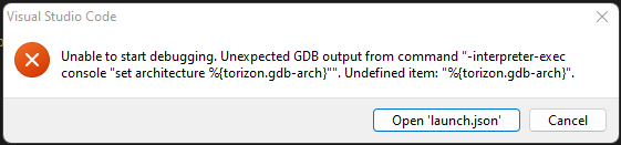

but now I get : unable to start debugging. Unexpected GDB output from command "-ineerpreter-exec console " …
I think ive seen this one before… I dont remember how I fixed it…
