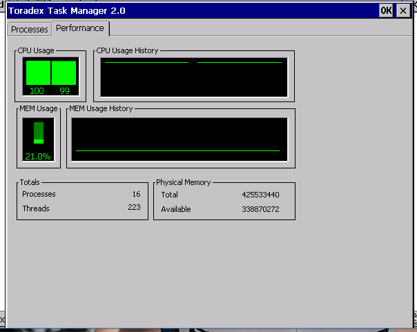

I’d like to know the core temperature. I assumed it would be possible with the Toradex Task Manager / Colibri Monitor. But the Performance Task Register is just showing CPU / RAM Load. But no information about the CPU.
Is the a build in Ferature to get the temperture easy (without extra programming affort)?

ok, but why the toradex Task Manager doesn’t Show the values? Also it should be able to enable or disable the dvfs.
Dear @BizBen
Displaying temperature and DFS configuration are simply not implemented in the TaskManager. We always try to focus our resources to implement features that bring the most value to our customer.
These features not rated important enough, especially as there are simple workarounds.
Regards, Andy
