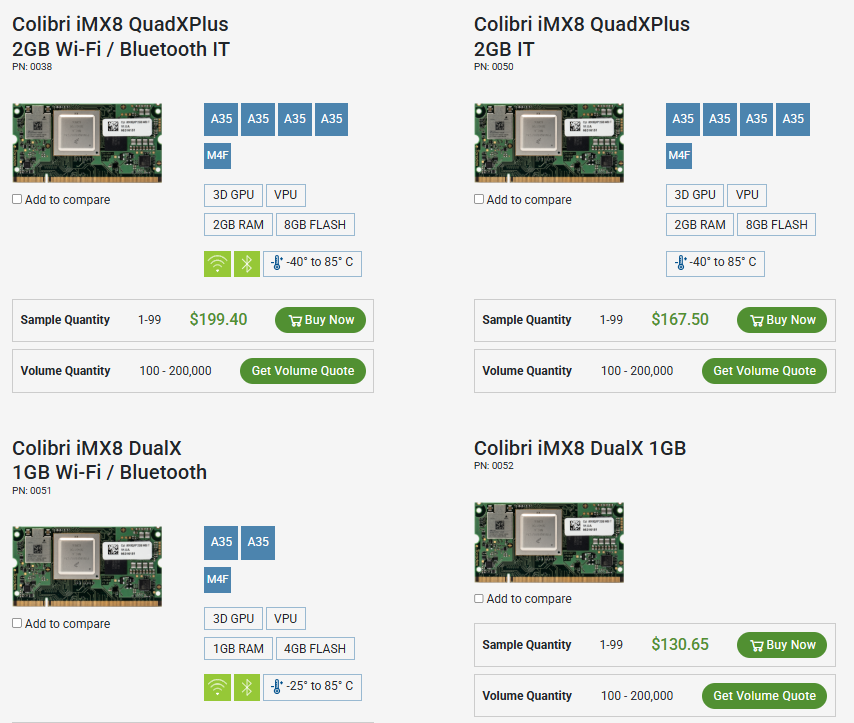

As shown on that page, the Colibri iMX8X module comes in four variants, and each variant may have its own hardware revision.
For effective troubleshooting, it’s important to know the exact module version you are using.

I have the QuadXPlus 2GB WiFi/Bluetooth IT (based on the sticker on my colibri)
