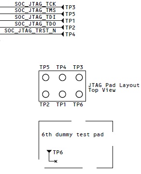

Colibri iMX7 Dual JTAG pin numbers for pogo pin connector?
I am not getting proper pin numbers for JTAG pogo pin connector which is avilable back side of colibri module.??
i am unable to interface JTAG ??
Refer to the schematic of an eval board to get the connection information.
Thank you @ abhijeet for helping me to solve JTAG connections problem.
Thank you @alex.tx for helping me to solve JTAG connections problem.
You are welcome. Thanks for the feedback.
