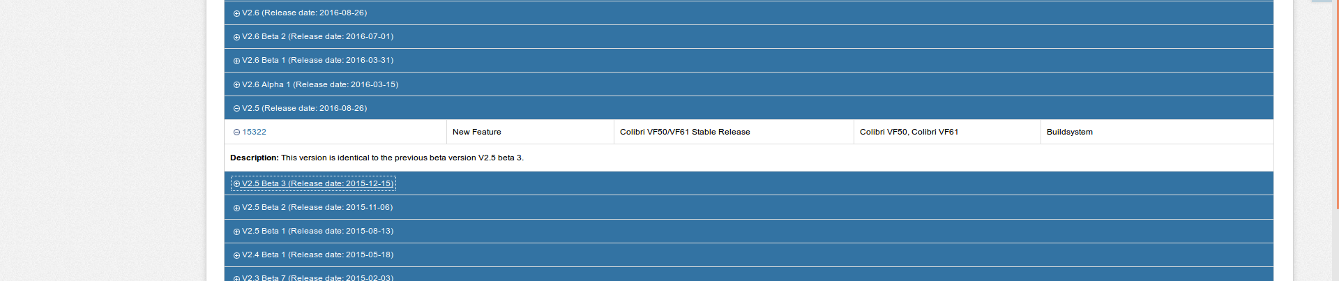

From toradex developer site there aren’t any information about beta/stable state of BSP [upload|/BNOISY3FW9LqvFWYNdBH8fqrCk=] . How can I distinguish that V2.5 is in beta and V2.6 (2.6.1?) is stable and V2.7 again is not stable?

That would be the correct place to check.

As I can see on that page it seems that my BSP is stable
So I can make it work on new module colibri V1.1A, right?
No, that release was exclusively declared stable for Colibri VF50/VF61.
