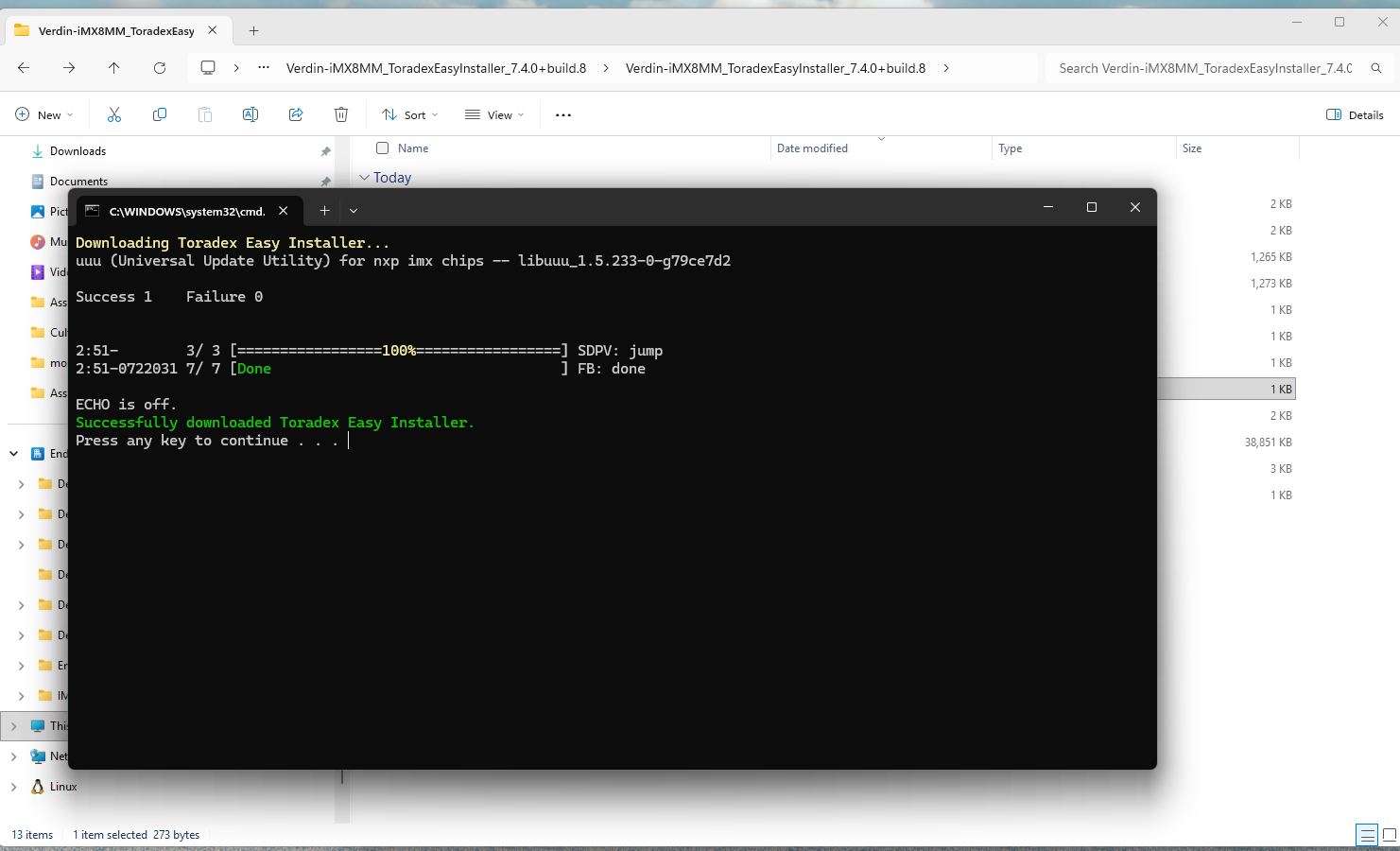

I have now flashed the latest Torizon OS 7.x image via Toradex Easy Installer (download & flash reported 100 % complete).
After reboot the module responds to SSH, but nothing appears on the monitor—the screen stays black.

I tried seveal times and at the end I was able to install os 7, no clue why it happend!!

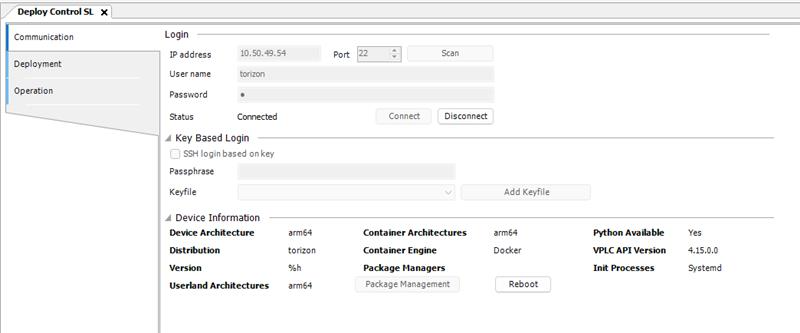

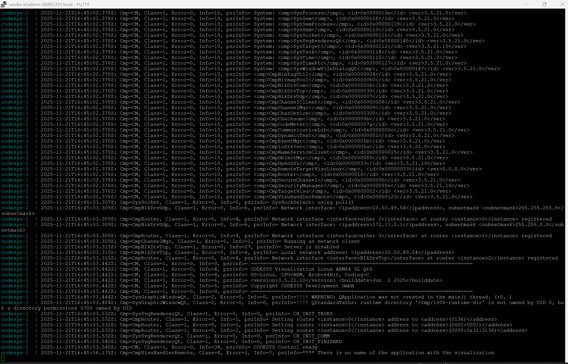

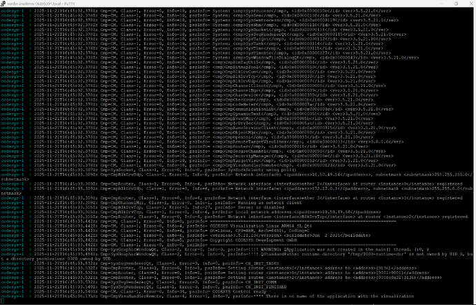

I run the
# docker compose up
and connct to the device via codesys and stuts is connced

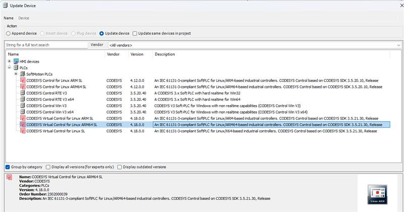

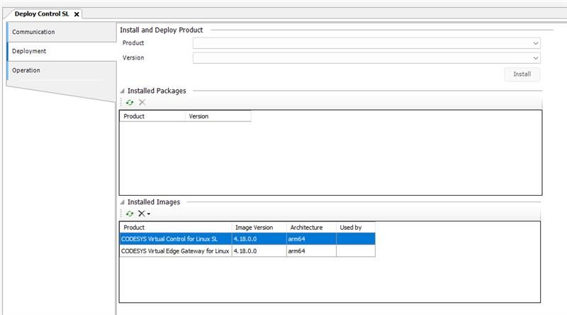

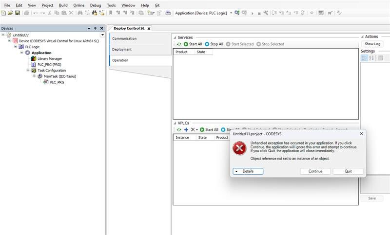

in the operation section when ?I want to create a new instance, I have this error when I click on the + icon
I rebbot the codesys software and open a new project , … nothing changed
my device is the same version:
something is missing there, like a reference to the runtime
Thank you so much for your Support.
