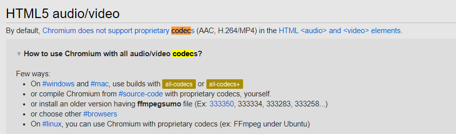

Currently when running Chromium through the Kiosk image, it is not possible to play .aac audio due to codec limitations explained here: Audio/Video (Chrome only)

Just to clarify regarding Chromium, the change I proposed is simply related to using alternate GN Flags, not touching anything source-related.
There is a proprietary_codecs
flag which should take care of everything, details at Audio/Video - The Chromium Projects
In your own tests were you able to get .aac
audio playing with Chromium (on any machine)?
So by default, a typical Chromium installation will not do so out of the box on any machine.
As I mentioned, even on a typical Windows machine, a fresh default install of Chromium will not play .aac.
On Windows, you would normally get an alternate build with all codecs from a specific company or vendor, example: Download latest stable Chromium binaries (64-bit and 32-bit) (woolyss.com)
Or you would get the necessary ffmpeg.so lib for that specific version of Chromium, from an alternate Chromium-based project like NWJS.
On Linux, some distros will also provide the `codecs-extra’ as a separate package that you can install. Prior to that, the proprietary codecs will ofcourse not work.
Lastly, you would simply build with alternate flags yourself.
I am also not sure if there are licencing matters at play here that dictate the options, but it would be great if we knew if this was an option that could be handled by Toradex or not.
