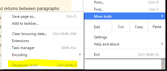

Chromium container has "Developer Tools" disabled
I noticed that torizon/chromium:3.2.0 container has Chromium “Developer Tools” disabled (i.e, grayed)
In the past I saw different Yocto builds (on different hardware) where it was available, so I don’t think it’s a yocto limitation.
How can I enabled it, please?

looking to my Windows 10 PC IO can say yes, “Developer Tools” is the same as “Inspect”.
But the problem is that on torizon/chromium:3.2.0 container, right click is disabled on every chromium page (even in the default home page).
It works only on Application bar
immagine
but it has different options.
Do you know why right click is disabled on the pages?

The right click works fine for me, I tried it on multiple websites and I can always inspect. It shouldn’t depend on SoM cause it’s the same container image underneath it all.
How are you launching your Chromium container? I had to add the --browser-mode flag to be able to right click.
Hi @jeremias.tx
you’re right, it works if I add --browser-mode to the command line arg to launch chromium (not chromium container), as described in
