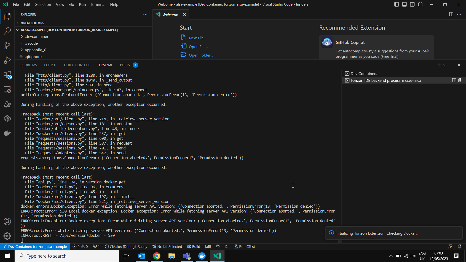

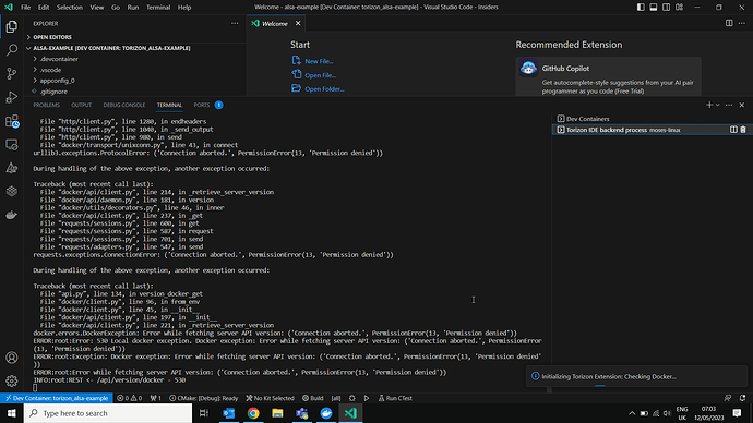

I have recently updated docker to the latest version. (Docker engine v23.0.5).
When I start vscode insiders, the torizon early access extension just does not start.
I get a warning as follows:
Docker seem to not be enabled for current user, this will prevent many of the features of Torizon extension from working. You may add your user to the docker group or run the Torizon IDE backend with an account that is part of that group.
Also, in the Torizon IDE backend process terminal, I see an error message.
Error 530: Local Docker exception. Error while fetching server API version.
