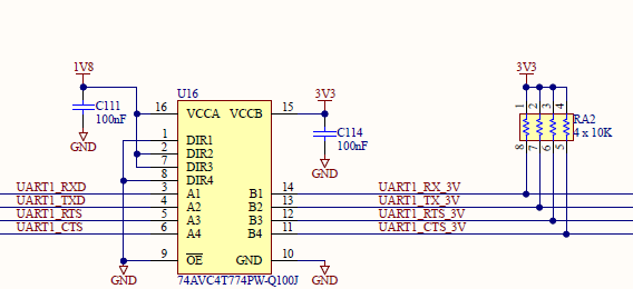

You can easily change the default Linux console to another UART using the U-Boot environment variable console.
Set it to ttymxc0 to use the RS-232 interface (UART1) on the Ivy board.
Unfortunately, changing the bootloader debug console is not as straightforward. Therefore, if it is acceptable for your sensor to receive some text over UART during the bootloader phase, this approach should work.
If that is not acceptable, you can use the UART1 3.3 V interface instead by soldering wires to the RA2 resistor array.
