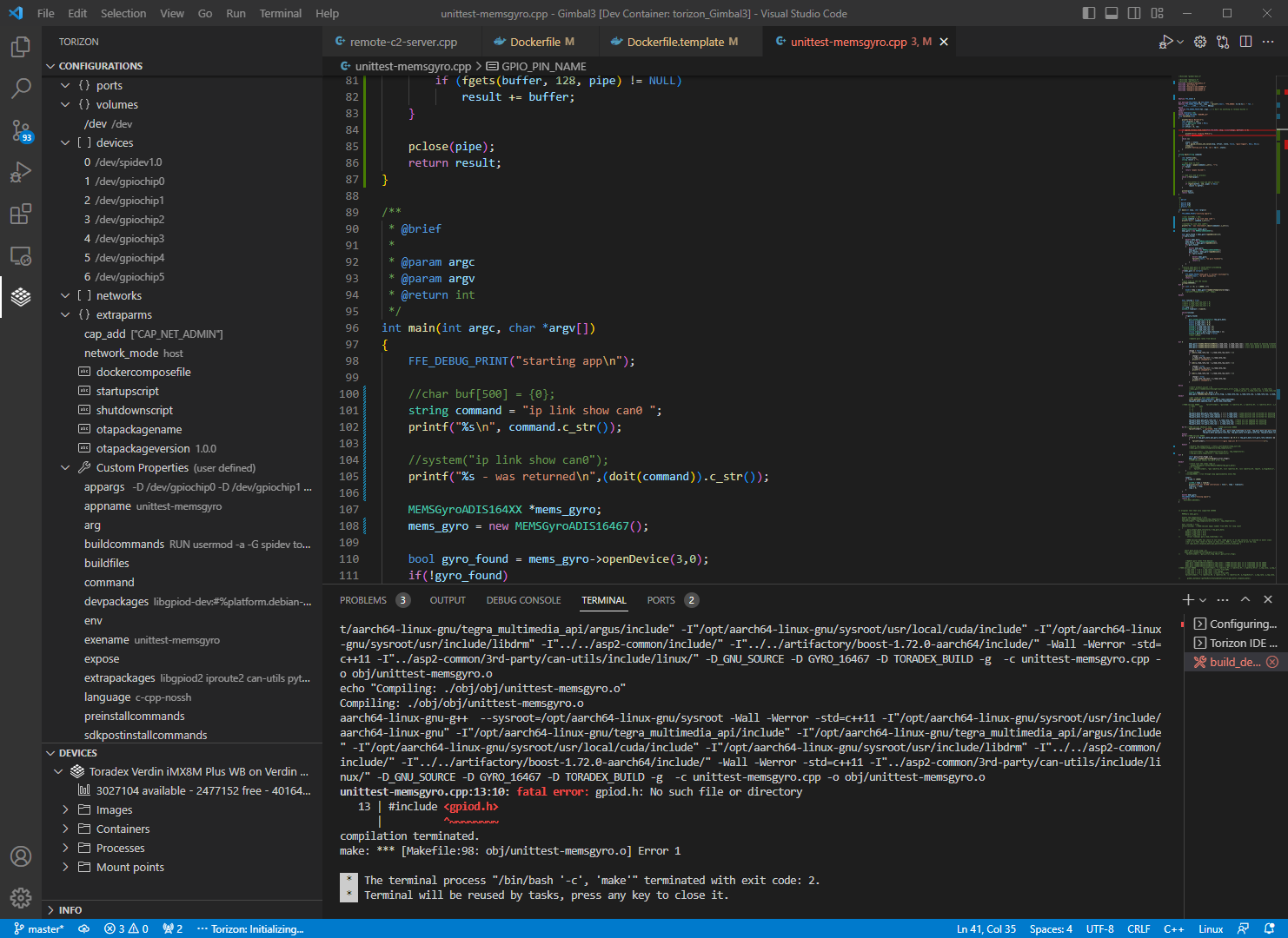

OK, I played around a bit with an Hello World! example code. Initiallly, I had the same problem. But I changed a few settings in the Torizon extension, and now it is finding the gpio.h file and compiling. At this point, I don’t know why it is working. I added in the devices, the /dev/gpiochip0-5 (one per line), and then it started working. I did the same to my other project, but there is no difference, it still fails to build. I’ve even added the additional libraries i needed for the other build to the working one and it still works.
in doing a comparison between the builds, the only thing I thought was a bit weird, was in the settings.json file this line was present under “files.associations”:, which is a bit weird:
“gpiod.h”: “c”. My other project has this under “files.associations”:
“limits”: “cpp”,
“type_traits”: “cpp”
and nothing with gpiod.h
Also, my other project is a C++ project not a C project. Could this be the issue?
Also, can you outline the specific settings in the configuration that affects the container that gets built? As a work around, can I point to the working container as a starting point and have it work or will it not work because it’s a C project?
The project that isn’t working is below.
Steve

The last image you posted shows that with your non-working project VSCode isn’t connected to a dev container, and so it can’t really find the packages added in devpackages. In fact, the extension isn’t being initialized correctly: see the Torizon: Initializing... message at the bottom of the window. That’s what is causing the problem: for some reason the extension can’t start correctly when opening your non-working project.

The error was that it decided it couldn’t write to the target directory. The directory was for some reason owned by root, and also under work in the local file it had an additional directory and executable which was old, so I deleted it. But it still will not pull in the gpiod.h file. If I comment that out, it compiles and runs just fine and I can step through code.
I made the c_cpp_properties.json files match as well as settings.json, extension.json and tasks.json. Launch.json and torizon-vscode-settings.yaml files match except for the exe names. The only real differences now are the docker containers and config.yaml which has name and key differences.

I figured out the problem. It was using another compiler, (aarch64-linux-gnu-g++) not the default one, (aarch64-linux-gnu-cpp).

I changed it back to using the g++ version and took a look at the includes that were in the original makefile. There were things that didn’t need to be there. And then it found gpiod.h. Not sure why that made a difference.

I believe the header file wasn’t being found because of what I said previously: Given that your first project wasn’t connected to the dev container, VSCode wasn’t inside the environment that has the libraries defined in devpackages. As for why the project wasn’t connect to the dev container in the first place, it is difficult to know for sure without more info.
Keep in mind that when you open a C/C++ project folder on V1 of the extension you aren’t connected to the dev container right away, you have to click on a pop-up message prompting you to connect to it.
