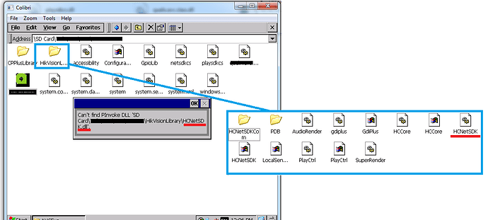

Please have a look the below image of error message
@Dhananjay
I think there is some server issue, the attachment is not working, can you upload the image here: https://share.toradex.com/ and share the link.
Please find the image from this link

What my requirement is to integrate the camera say CPPlus / HikVision in Colibri T20 smart device winForm. For this what I do is, import the Dll which are developed in C++ enter code here
[DllImport(@“FlashDisk\CameraDll\HikVisionLibrary\HCNetSDK.dll”)]
public static extern bool NET_DVR_Init();
and have placed all Dlls in "FlashDisk\CameraDll\HikVisionLibrary" but when I access the method “NET_DVR_Init()” this issue has come Can't find PInvoke DLL 'FlashDisk\CameraDll\HikVisionLibrary\HCNetSDK.dll'.
please help me how to resolve.
