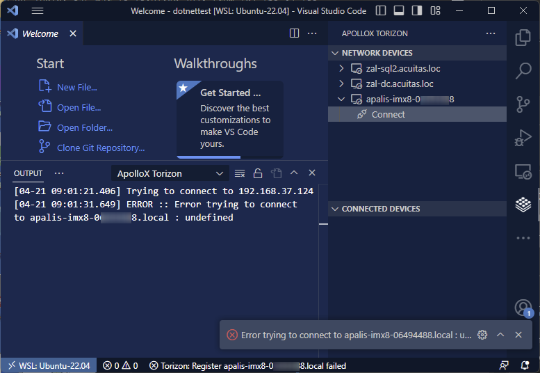

After installing the extension I was able to connect but got strange error messages. I then reinstalled Torizon on the module and now I can no longer connect. The error message doesn’t say much:
[04-20 10:56:31.137] Trying to connect to 192.168.37.124
[04-20 10:56:41.089] ERROR :: Error trying to connect to apalis-imx8-06494488.local : undefined
grafik
If I enter the wrong username or password, I get a different error message.
Connecting to the device with the + symbol and entering IP address doesn’t work either.

Hi @lucas_a.tx
Error is: ERROR :: Error trying to connect to apalis-imx8-06494488.local : undefined
I’ve already removed the device from the “connected devices” pane. Before I tried to connect once. Probably this caused the issue?
I only see this error in “Output”. Are there any other logs? Or is there another way to test the connection? Inside WSL Ubuntu 22.04 I can connect.
Hi @Qubit ,
you can try “CTRL SHIFT P” in VS Code and enter “Logs” which should bring up “Developer: Show Logs”. Select this entry and then select either Extension Host or Extension Host (Remote) - it depends on where the ApolloX extension is installed. This should bring up a more detailed log regarding extensions.
