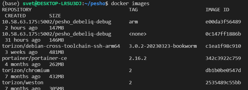

These are the docker images I have:
Where the first one, pesho-debeliq-debug is the used container.
My colleague has a suspicion that curl is not available on the debian-cross-toolchain-ssh-arm64 which should be the container to link the code.
And we are wondering if we should link the curl there somehow or add curl library to this container as well in order to work.
