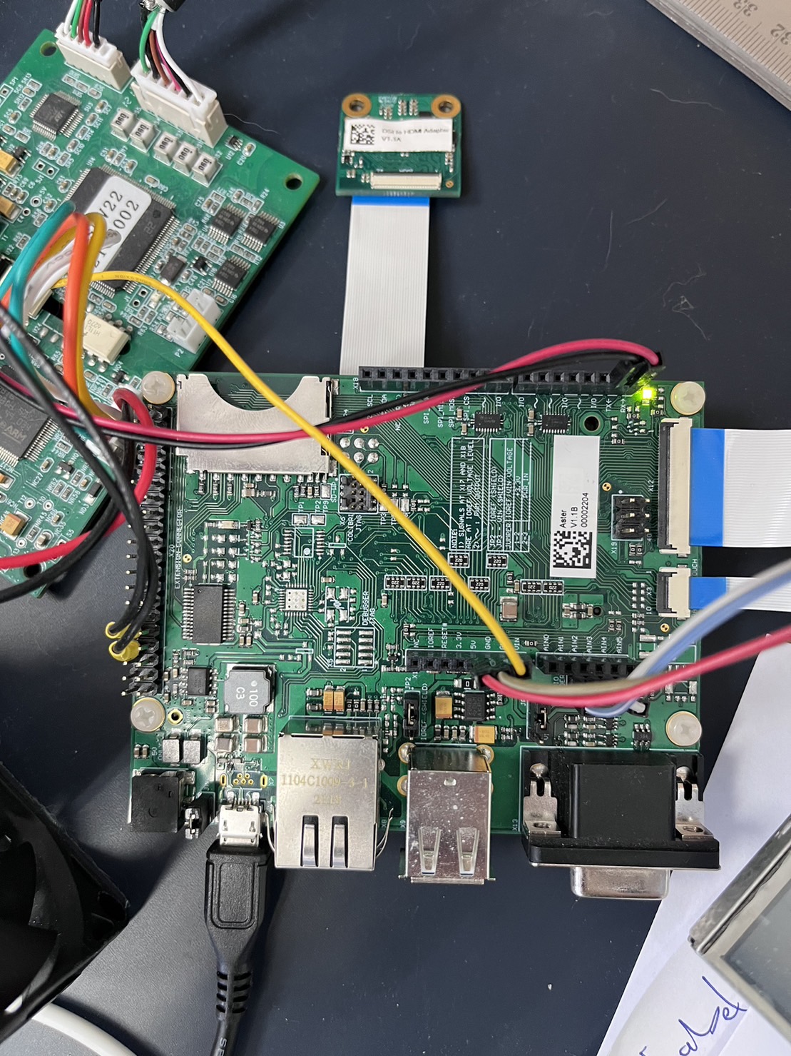

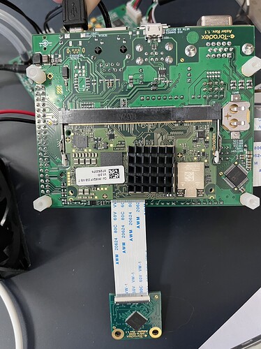

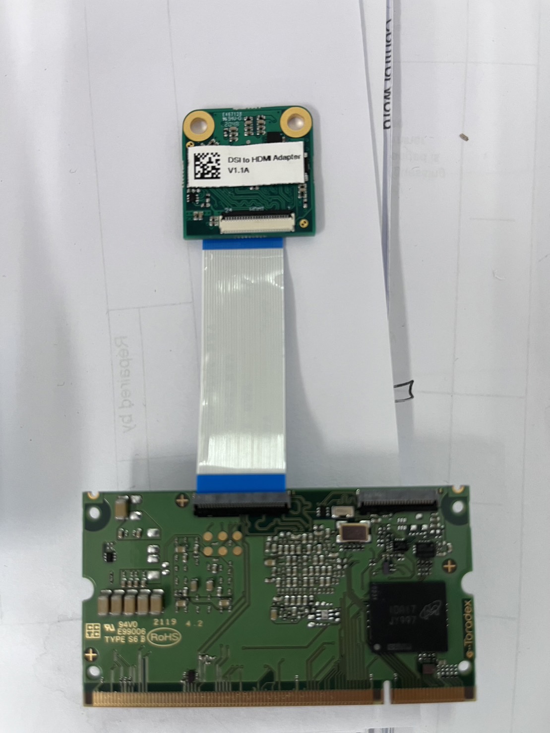

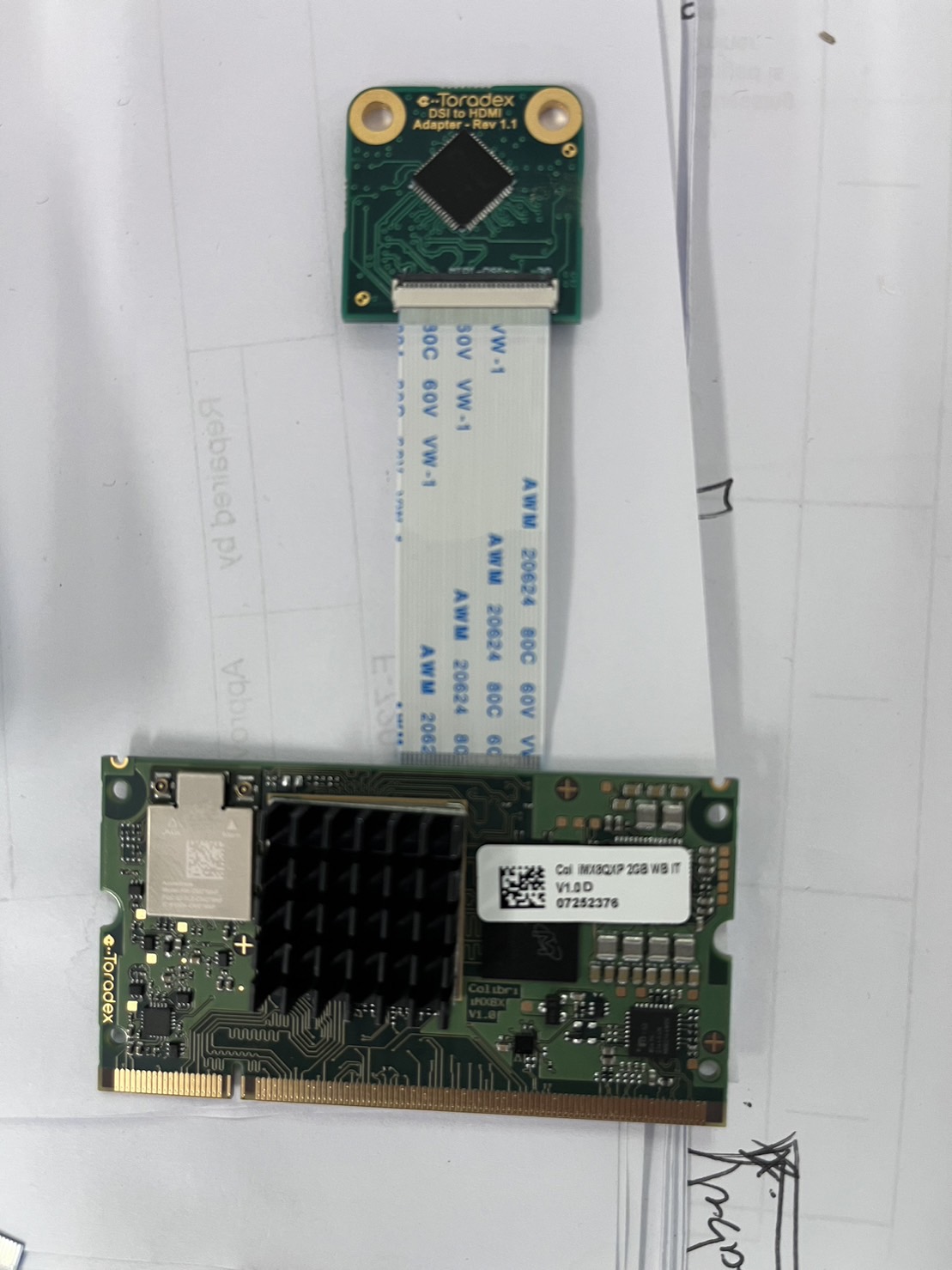

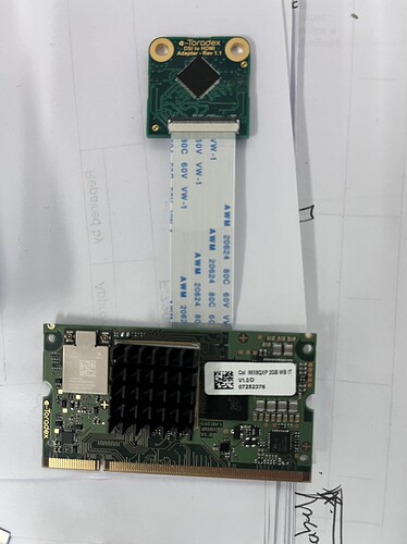

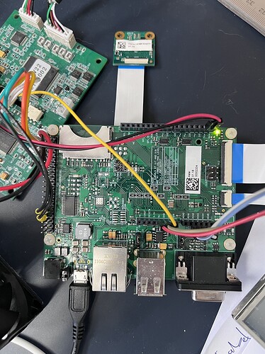

Could you please provide detailed pictures of your setup?
Please review my set up.
The Aster Carrier is powered by 5V USB from Laptop
Aster Carrier Board<=> Colibri iMX8QXP <=> Colibri DSI to HDMI adapter
Aster Carrier Board <=> Display resistive touch display 7"
Connection of DSI to HDMI Adapter looks OK and shouldn’t cause any smoke. Most likely you get smoke from another board connected to your Aster board.
From other hand - how are you going to connect HDMI monitor? Aster board has no matching FFC . connectors. You will need either to use another carrier board like Iris and Colibri Evaluation board or use the Colibri HDMI Adapter.
