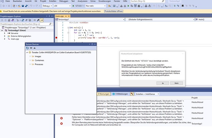

Cannot compile torizon example
i could follow the Torizon tutorial up to step
“Build and Run your First C Application” - Step 15: Debug an Deploy.
It fails with an error in the connection error. It keeps on asking me
to verify the hostkey for 127.0.0.1 …
No matter, what I click, it always fails
It also produces an error log, see attached.
I also have the moses.exe log open - no errors there
Any help is greatly appreciated.
Kind regards
Thomas

Dear @t_achmann,
Thanks for using the community.
It seems to be an issue with the fingerprint mentioned in the error. Toradex does not save them, but in this case it is managed by Visual Studio itself. The key for the host does not match the one used by the SDK. To fix this you can try to clean the “known_hosts” file.
What version of the extension are you using? Is it the “stable” or “developer” version?
Let me know about your progress.
Kevin
Hi Kevin,
so far no progress …
Just tried to connect via ssh from Powershell to Container - success.
But VS2019 is still a problem.
I’m using the stable version
Thomas

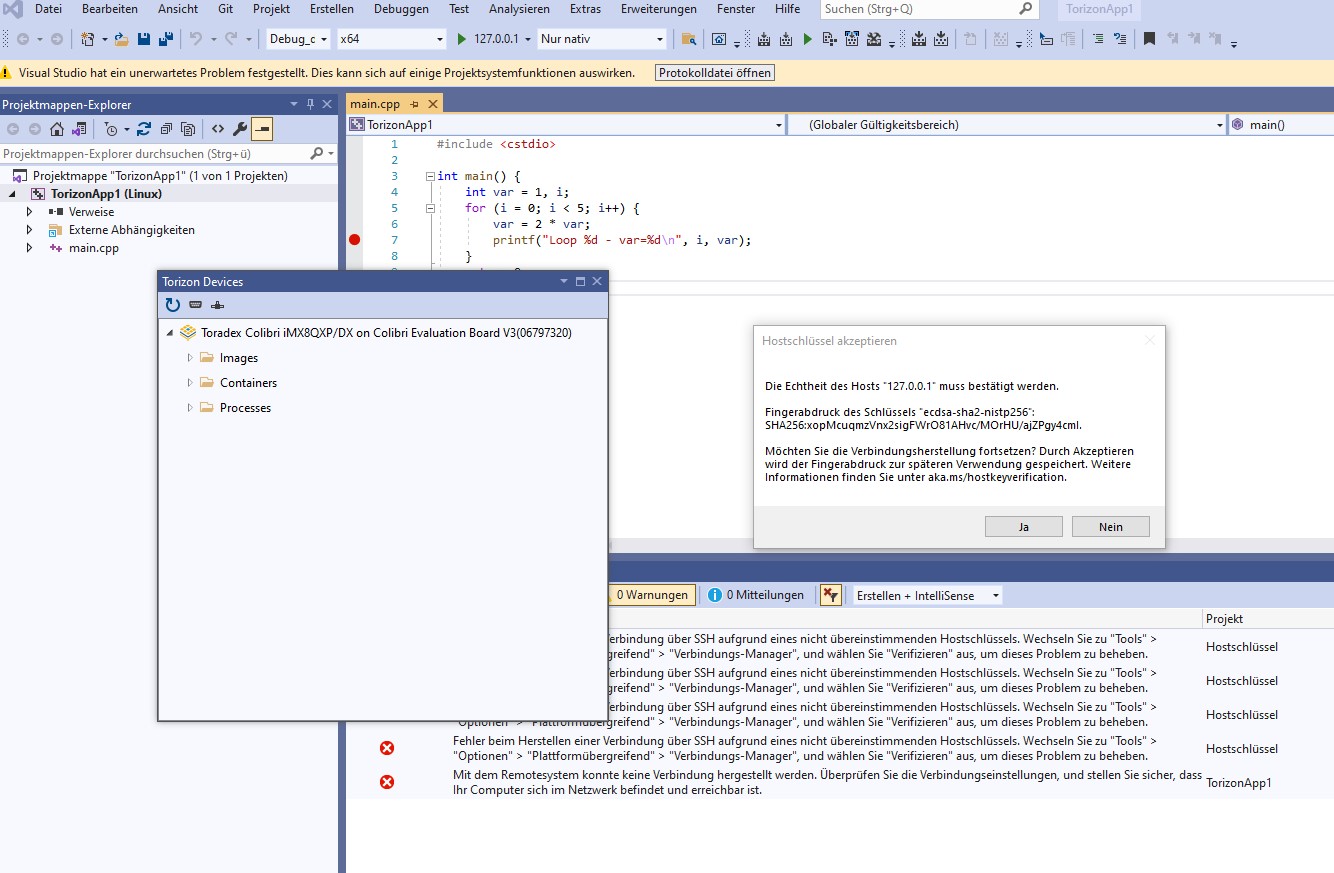

[upload|ahBYQho3dH6zJKUwQKPWp78KRDw=]
[upload|sNVrG1P2yXo6Z4EPztCfIJN66ag=]
Hi @t_achmann ,
okay thank you for the information and the screenshots.
I will try to reproduce the issue on my end. In the mean time, would it be possible for you to test the “early access” version of the VS extension? There’s a possibility that this fixes the issue.
Kevin
