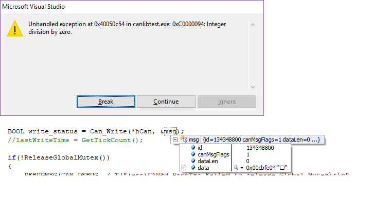

When I send a CAN message with 0 length, the Toradex function Can_Write crashes with a divide by zero exception.
The image shows the code and the exception message from VS 2008.
Dear @robmac
I can confirm this is a bug in our library implementation, I already found the reason for the failure. We will fix this in our next library release V2.3.
If you need an urgent solution, I can send you a preliminary version of the libraries with this bug fixed.
Regards, Andy
