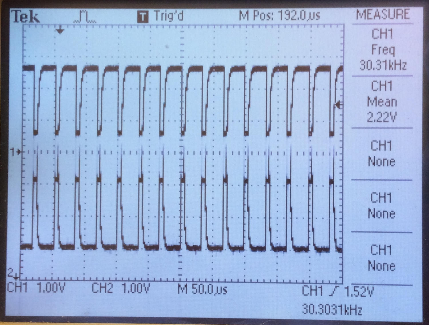

And we cannot receive any data using USB-CAN adapter. Also we have tried to receive data using
candump can0
This results in nothing but:
interface = can0, family = 29, type = 3, proto = 1
We have tried several bitrates (125000, 10000 etc.) with same result.
The oscilloscope shows the same picture regardless bitrate and data sent (see below). Channel 1 is CAN-L and channel 2 is CAN-H. The frequency (ca. 30 kHz) is quite strange. The pattern doesn’t change while various data is transmitted.
