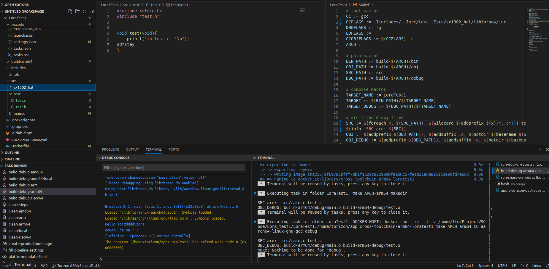

First, my starting point was to create a new container project based on vscode extension2 torizon C template.
The sx1302_hal folder is placed into src/ folder.
I modified the makefile to first, build the sx1302_hal archive (sx1302 makefile target) , and then run the 'toradex ’ origin debug target. By doing that, i’m sure to have the libxxx.a with all the code i will use in my main.c ( or additional .c files) cross compiled for my target arm64 am62 board.
sx1302_hal:
$(MAKE) all -e -C src/sx1302_hal
.PHONY: debug
debug: sx1302_hal $(TARGET_DEBUG)
To use the library, i add -l and -L options to the LDFLAGS:
CC := gcc
CCFLAGS := -Iincludes/ -Isrc/sx1302_hal/libloragw/inc
DBGFLAGS := -g
LDFLAGS := -Lsrc/sx1302_hal/libloragw/ -Lsrc/sx1302_hal/libtools -lloragw -lm -lparson -lbase64 -ltinymt32 #-lm is for math.h (to avoid compile errors :pow , log10 functions calls)
CCOBJFLAGS := $(CCFLAGS) -c
ARCH :=
- Issues I met were:
->Pb1 : sometimes modifications done in src files were not taken into account by the makefile, so object files were not regenerated.
->Pb2 : If i removed the main.o, not regerated and then ask for it in compilation errors (make).
->Pb3: Container pull step were giving error 18 on my stationnary pc.
Pb1: fixed when create a new project
Pb2: fixed by replacing makefile
Pb3: fixed by moving from my home network to the work pc and work network
So to conclude, to day all is working.
I think that playing and experimenting with makefile, VS an extension at same times created some stange situations.
Now, i’m able to call a function of the sx1302 library ( just get_version(), not yet real communication with the hardware), but it is a good start.
