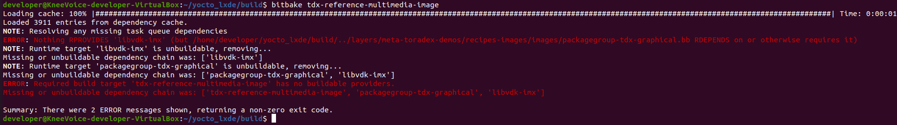

I simply want to build tdx-x11 for the Verdin i.MX8M Plus on the full sized development carrier.
I dutifully followed the pre-req instructions. Got all the needed packages installed on the Ubuntu 20.04 LTS development VM. I curled down repo, created a directory and did the following:
repo init -u https://git.toradex.com/toradex-manifest.git -b dunfell-5.x.y -m tdxref/default.xml
Here are the questions:
- Why does one have to build the wayland package to get x11? Wayland is mostly useless to anyone who needs to use yocto because almost everyone needs a valid X11 distro, that’s how we got to yocto in the first place.
- Why doesn’t tdx-x11 build up from the minimal layering on xserver-xorg?
- Where are the build instructions to build tdx-x11 for i.MX8M Plus?
This should not be impossible. We should not have to walk backwards from Wayland.
Admittedly I’m not good with yocto. I’ve watched most of the Toradex youtube videos on yocto, but cannot figure this out. One should not have to walk backwards from an incompatible distro.
