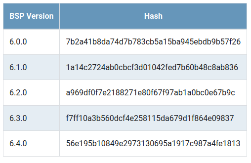

From https://git.toradex.com/cgit/meta-toradex-bsp-common.git I’ve checked out the Hashes for Version 6.1.0, 6.2.0, 6.3.0 and 6.4.0 all with the same outcome.
