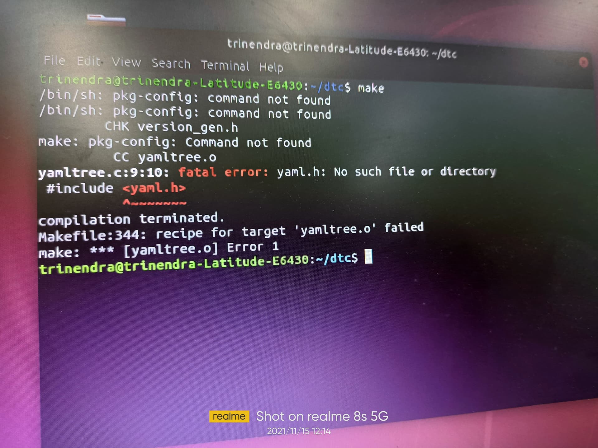

Here I am trying to do Build U-Boot and Linux Kernel from Source Code .
At the stage of building the Device Tree Compiler (DTC) Tool.
after executing the make command.
I was getting error.
The error message is
yamltree.c:9:10: fatal error: yaml.h: No such file or directory
** #include <yaml.h>**
please some one help me to sortout this problem.
note :I was opend the dtc folder there is no (yaml.h) such file.

after running the $ make command i was getting errors.
erreor logs:
please let me know i am in right way or not.
Hi @TRINU
Looks like you have not installed pkg-config in your development PC.install pkg-config and try again
“sudo apt-get install -y pkg-config ”

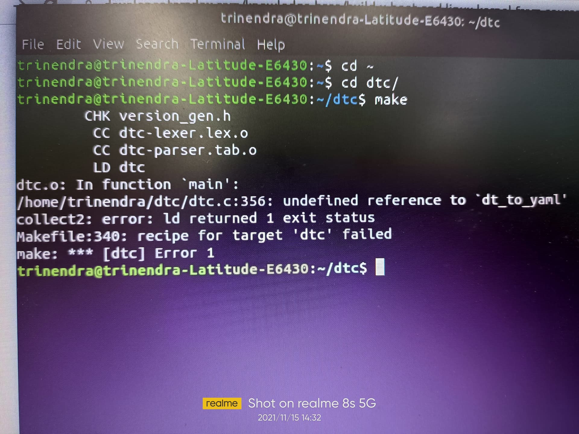

after installing “ sudo apt-get install -y pkg-config ”
some other errors are getting.
error msg

Hi @TRINU
You have to clean and then run the make command.
1. make clean
2. make
