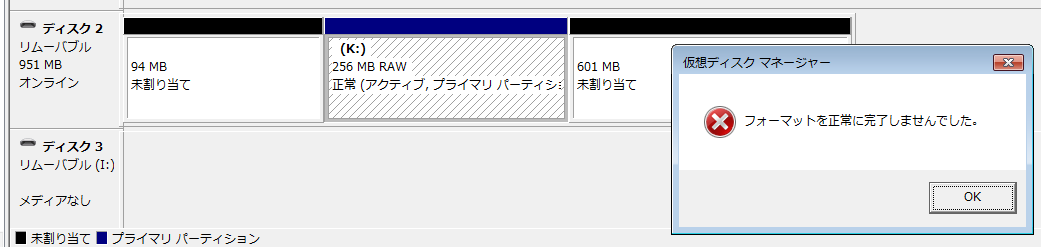

Dear Valter.tx
Because my environment is Japanese, it will be a message of English translation, but in a dialog message, “Windows could not complete the formatting” is displayed.
FAT, FAT32, exFAT, NTFS, Whichever file system you choose, the same error is displayed.
Dear imagemiyamoto.tx
Yes. When inserting the SD - card, the PC is asked to format it.
The image is the display of the SD card in “Disk Management”.
Can you try to format it by right-clicking in file explorer? I think that the option in disk manager works if you already assigned a file-system to the partition. The partition is marked as FAT, but this may mean different filesystem in Windows. If you right click on the card in explorer you can select FAT32 and format it, this should work.
