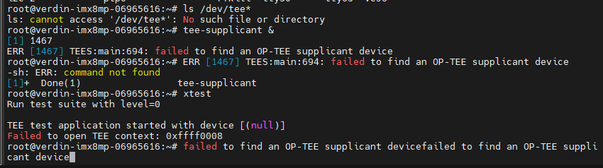

But after the above operations, I found that the tee node is missing in the /dev directory, and tee-supplicant cannot be started, and the following error is reported:
ERR [1467] TEES:main:694: failed to find an OP-TEE supplicant device
Are there any steps I got wrong? Or what steps am I missing?

Hi @008kai , first, an optee node is requred in the device tree. Meanwhile, you may also need a customized u-boot for OP-TEE. There was a discussion here. But we have no off-the-shelf source code or binary for OP-TEE.
I added the firmware node in u-boot’s device tree file, but the situation didn’t change. The discussion at the second link was inconclusive. Can you provide specific steps to build optee using yocto?
To make OP-TEE work, the customized u-boot, kernel, device tree are required, as well as optee related tools. However, we don’t have a step-by-step guide to enable it.
What changes do I need to make to u-boot, kernel, device tree? Can you give some guidance? I didn’t find anywhere else where optee was successfully enabled on the imx8mp board。
