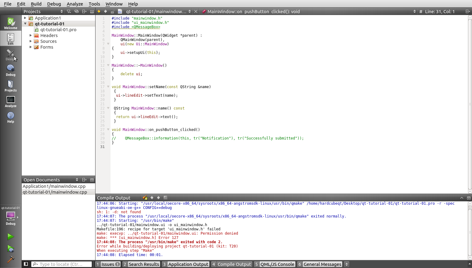

I tried to cross compile QT application for Colibri T20 . But unfortunately I ended up with the following errors. I’m unable to sort out these errors. To setup the Oe-core and installation of SDK , I followed this link.
In issues I got this
:-1: error: execvp: ../qt-tutorial-01/mainwindow.ui: Permission denied
In General Messages I got this
Failed to set up kit for Qbs: Could not determine whether Qt is a static build.
17:01:58: Starting: “/usr/local/oecore-x86_64/sysroots/x86_64-angstromsdk-linux/usr/bin/qmake2” /home/dev1/Desktop/qt-tutorial-01/qt-tutorial-01.pro -r -spec linux-gnueabi-oe-g++ CONFIG+=debug sh: 1: -d: not found
17:01:58: The process “/usr/local/oecore-x86_64/sysroots/x86_64-angstromsdk-linux/usr/bin/qmake2” exited normally.
17:01:58: Starting: “/usr/bin/make” ../qt-tutorial-01/mainwindow.ui -o ui_mainwindow.h
Makefile:196: recipe for target ‘ui_mainwindow.h’ failed
make: execvp: ../qt-tutorial-01/mainwindow.ui: Permission denied
make: *** [ui_mainwindow.h] Error 127
17:02:00: The process “/usr/bin/make” exited with code 2.
Error while building/deploying project qt-tutorial-01 (kit: T20)
When executing step “Make”
17:02:00: Elapsed time: 00:02.

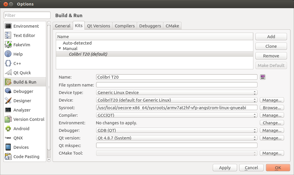

I’m unable to resolve this “Permission Denied” issue. I have attached the build and configuration setup screen shots.][1]][1]

Thank you . Now I could run my application on COlibri T20 board. But I’m unable to compile the software using qtcreator and I could compile it in terminal by doing some changes in makefile. In the make file that was generated using qtcreator kit, the GCC, GCCXX, debugger and linkers were set for the X86 machine even though I manually organized the kit for colibri T20 using corresponding tool-chains.
Kit compiler config is not being properly used by qtcreator currently. You’re having issues because you’re not running qtcreator with a proper environment. You have to source the environment and then run qtcreator in the same console.
Thanks for your support. I forgot to choose the path for qt mkspec. This was the issue and after giving the exact path for the qt mkspec , I could cross compile my application on qtcreator without modifying the make file.
