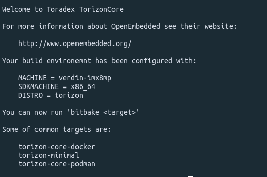

Here are the commands I am running:
dev@ubuntu-22-server-dev:~/workspace/toradex$ MACHINE=apalis-imx8 source setup-environment build
Welcome to Toradex TorizonCore
For more information about OpenEmbedded see their website:
http://www.openembedded.org/
Your build environemnt has been configured with:
MACHINE = apalis-imx8
SDKMACHINE = x86_64
DISTRO = torizon
You can now run 'bitbake <target>'
Some of common targets are:
torizon-core-docker
torizon-core-podman
torizon-core-lite
dev@ubuntu-22-server-dev:~/workspace/toradex/build$ bitbake torizon-minimal

Can you run the repo init/sync with the manifest branch 6.x.y (i.e -b kirkstone-6.x.y )
What you see of “torizon-core-lite” is an older name for torizon-minimal. So I believe you need the correct branch.
Also, Do you have specific reasons for using the minimal Torizon OS vs Torizon OS? It’s also quite easier to build a custom image with TorizonCore Builder vs yocto, but it comes downs to your needs.
I’ll look into the boost topic, there may be something that fixes itself with a more up to date build, but I don’t believe torizon-core-docker vs torizon-minimal will show any different. Let me know if it does.
The Torizoncore-Builder tool uses yocto on the back end, so you end up with the same image. In a too simple statement, it’s a trade off between speed and flexibility. If you don’t need the flexibility of yocto, Torizon OS will be much faster application development.
