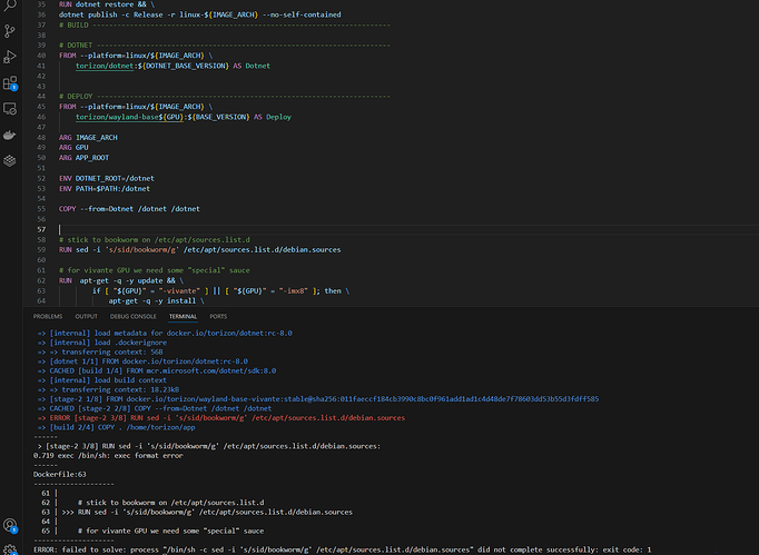

I am trying to build the Docker image for avalonia applicationto deploy it on the SoM using the Dockerfile.
Here is the output error after trying to build the image.

Greetings @Ahmed49,
I don’t seem to be able to reproduce this error. I created an Avalonia Frame Buffer DRM project, then without modifying anything started the build and debug process. It worked fine on my side without any errors.
Did you modify your project in any way after the default creation?
Can you reproduce this issue? For example if you create another Avalonia project does the same issue happen there as well?
