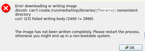

When I copy top_folder onto a USB driver and install it using the easy installer it works just fine. However, when I do it via ethernet, it fails to download the images (while all other files download without problems) because of the additional directory. The following error message occurrs:
Seemingly because it fails to create the additional directory. If I place the files in the same directory as image.json it works without problems.

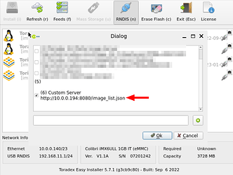

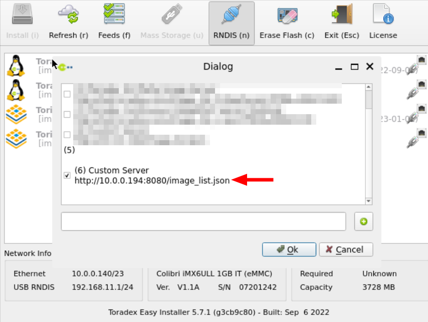

From the folder above, I run the following to start an HTTP server:
$ pwd
tezi-server-feed
$ python3 -m http server 8080 # sudo is needed for port number < 1024

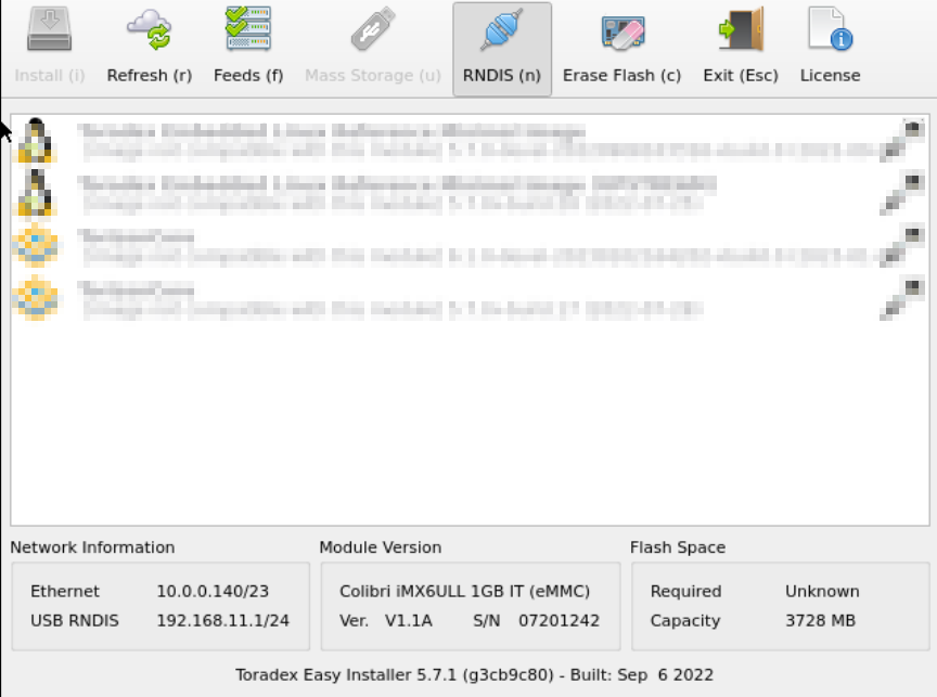

Then from Toradex Easy Installer UI, I add my server:
And I can see my images:
Let me know if this helps you

Thanks for your insights. I think my usage of the word “Image” is not very precise. Having multiple Toradex Easy Installer Images in separate folders is not a problem and I do it as you do. The problem I am describing occurs when I have a folder inside of the folder of my Toradex Easy Installer Image in which I store all files that shall be installed onto the board (which I called images in my post). I prefer having images in a folder instead of a flat structure since for one Easy Installer Image I need a lot of files and having them mixed up with the wrapup script, marketing, image.json etc. is not very appealing. Using such a structure for USB install works without problems, as referencing the filenames in the image.json works with a relative path, as shown in my initial post.
However, when using the same folder structure for Ethernet install it fails as described above because curl wants to download the file into /run/media/tmp/[filename as taken from image.json] and if the filename contains a relative path, curl fails because the path does not exist on the board yet. So a fix would be to create the parent folders of the file beforehand.
