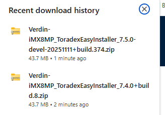

Thank you. The links now work. I’m not sure what was wrong there.
