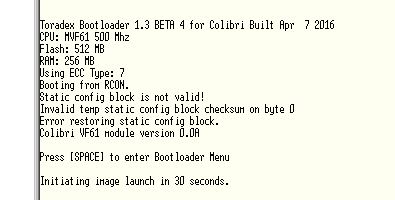

One more issue I add picture with my bootloader menu. I don’t know what is the message Static config block is not valid!
You can use update tool to backup config block and restore it on another module.
Also remember if you do not have correct config block you will have issues with drivers as they read module information from FCB.
Ok, I got it the Static config block… error is FCB fault.
