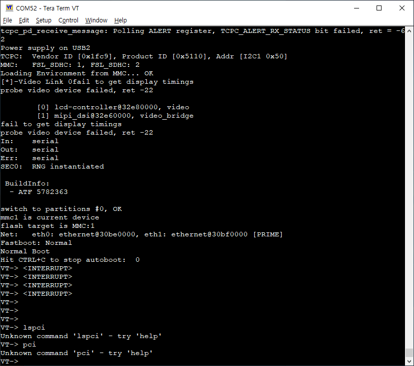

  2. Is it currently possible to configure U-Boot to boot entirely from the NVMe drive?
I came across this older forum post, which mentions that booting from PCIe/NVMe was not supported at the time. Is this still the case?
Additionally, I found that NXP provides a patch for enabling PCIe support in U-Boot for i.MX8M Plus:
Would it be possible to apply this patch and use it with Torizon OS to enable booting from NVMe?

The Verdin iMX8MP module is fused to always boot from the eMMC.
Therefore, at least the bootloader will need to be in the eMMC.
From a bootloader in the eMMC, you could boot to other media.
This requires that the other media is supported by u-boot.
The patch you pointed out may be needed, however I would recommend that you check for support of PCIe and NVMe in the u-boot version we have for the Verdin iMX8MP.
This information can be found here: Release Matrix - Kernel/U-Boot Version | Toradex Developer Center
Since Torizon OS/BSP 7, we use an upstream u-boot for the Verdin iMX8MP, so this patch is very unlikely to apply.
Storing the OS in an NVMe drive is not a use case we actively test and support, so it would be a custom implementation that will bring more maintenance work later.
