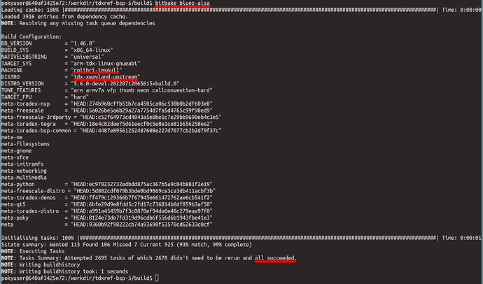

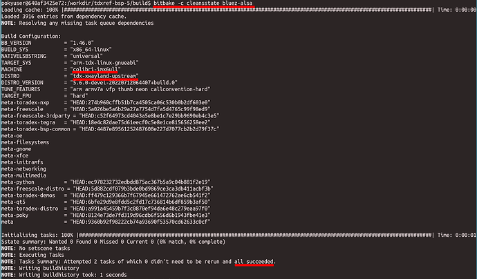

I just ran the cleansstate for bluez-alsa using MACHINE=colibri-imx6ull:
And then I ran bitbake bluez-alsa without issues:
Could you please perform a cleanall on the recipe bluez-alsa and try to execute the configure again?

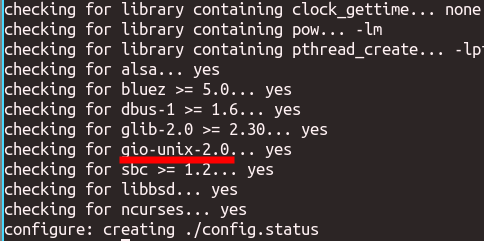

Hi @EJA !
From my log.do_configure, I see that I have that dependency met:
Researching for gio-unix-2.0, seems like it is related to glib. Reference: installation - How Install gio-unix-2.28.0 - Ask Ubuntu
We have the glib-2.0 recipe in layers/openembedded-core/meta/recipes-core.
And bluez-alsa shouldn’t even try to build if glib is not in place, as the former has a dependency on the latter (you can check it from bluez-alsa content).

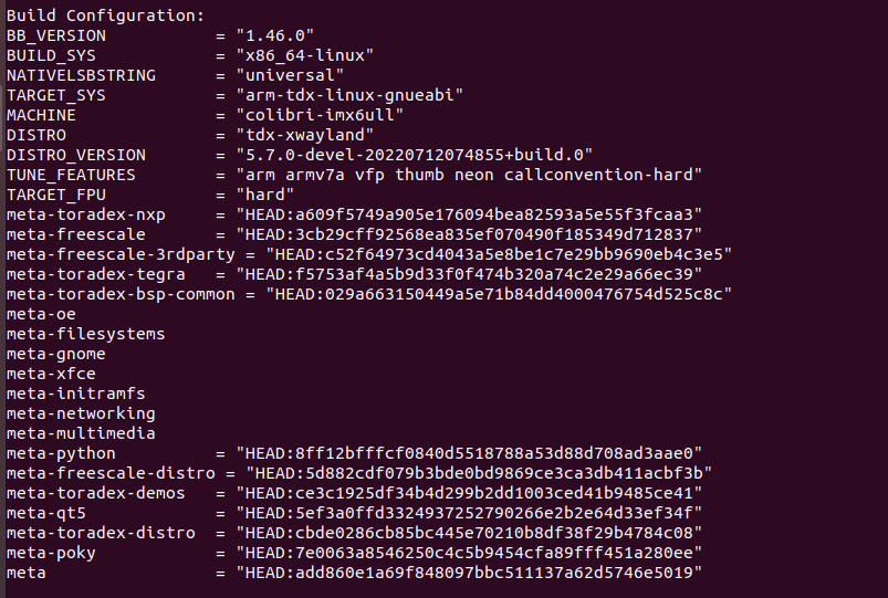

Which BSP version are you using?
Yes. It is present in the path you provided.
I think its 5.0.0
Hi @henrique.tx ,
Is this helpful?
This is my kernel version
MicrosoftTeams-image (1)
