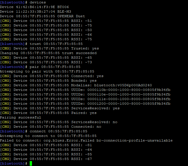

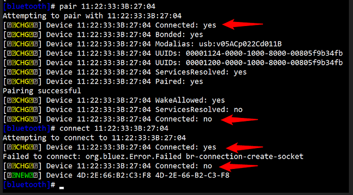

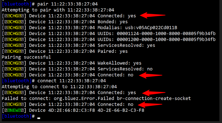

Hi @kevin.tx,
This recipe also works for me with my mobile phone but not with other BT devices.
For example, when I try to connect to a handsfree I get the following error:
Failed to connect: org.bluez.Error.Failed br-connection-profile-unavailable
When trying to connect to a Remote Control Smartphone I get the following error:
Failed to connect: org.bluez.Error.Failed br-connection-create-socket
Have you tested with other BT devices?
Julián

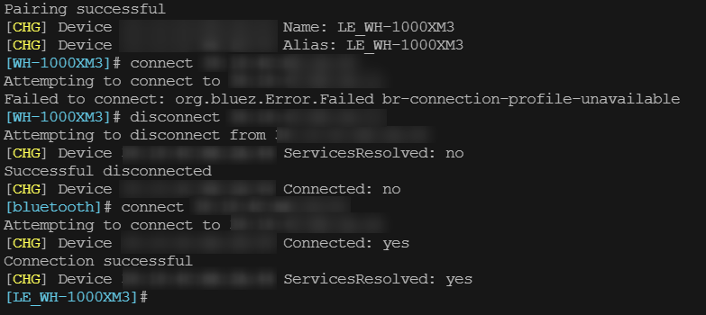

Hi @jbruno ,
I forgot to mention I also did the command trust <MAC_ADRESS> before trying to connect.
So this is my try with my headset:
I got the same error as you. But in my case the device got already connected when I paired it. (This is a fresh installation of the minimal image by the way)
Did you ever try to do a disconnect after pairing to see if that changes things?
Kevin
Hi @kevin.tx,
I have three different handsfree models, one of them is an AfterShokz, and with all three devices I get the same fault.
In your screenshot, the device name seems to change from WH_1000XM3 to LE_WH_1000XM3. Could you please explain me why this change?
I have run the disconnect command and it hasn’t solved the problem. Any idea what could be happening?
