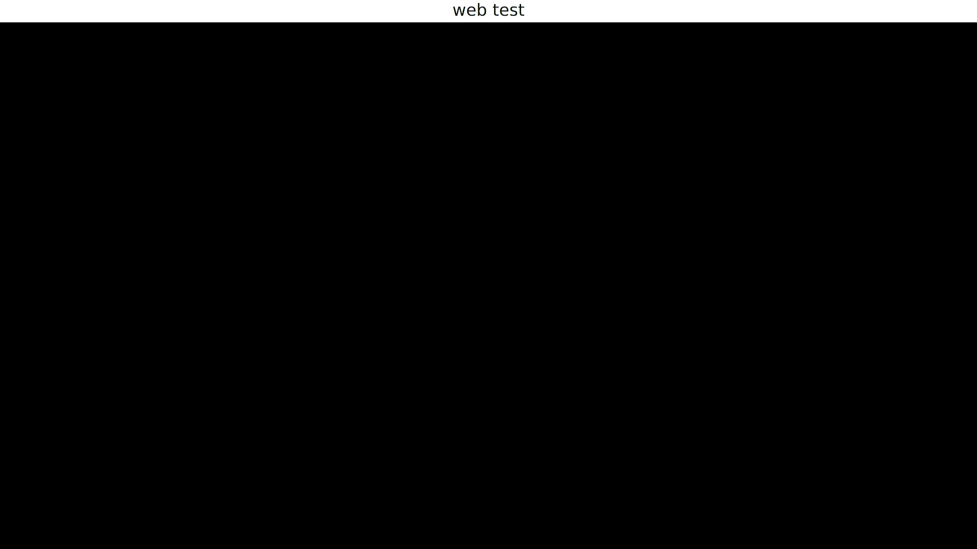

I’m trying to display a web page using PySide2 and QtWidgets (QWebEngineView) or QML (WebEngineView), but all I get is a black rectangle where the web page should be.
For example, the code bellow shows the label at the top and a blank rectangle bellow it, like in this image:

I get no errors in the command line when starting the app and I can see the ~/.cache and ~/.local/share/ get some references to the url I’m trying to display (“google”, in the above example).
Installing lynx in the container allows to navigate just fine.
Any ideas what I am missing?

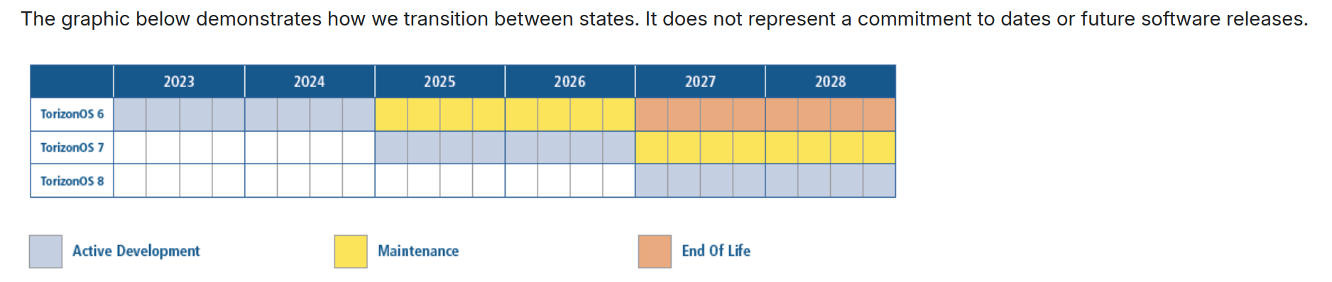

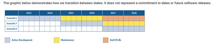

Hey @borco ,
On Trixie, I can only refer to this comment my colleague made here. In that Trixie for Torizon OS 7 is most likely not on the roadmap. But when updates of Debian containers happen can be seen with major OS updates, although as you can see, Torizon 6/7 share bookworm. It could be possible that if a change is made, It could be beyond Trixie.
Torizon 5 → bullseye
Torizon 6 → bookworm
Torizon 7 → bookworm
Here is our OS roadmap for Lifecycle for reference:
